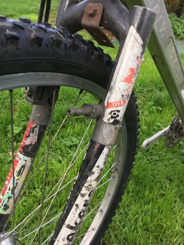

Are the forks wearing the maguras pace? Are the maguras fitted to standard brake bosses or dedicated magura mounts? Hopefully it's standard brake bosses or you have the added pain of sourcing the correct brake mounts for the forks.

Post a pic of the bike, would be nice to see and I'm sure help us all assist with your brake choices.
Thanks for all the replies so far. She won it at the 1996 European Cycle Messenger Championships. I'll have to ask my Dad to check for a model no (it's at my parents place since we only just moved to a big enough place with a garage to start housing our full collection) but she remembers it being a few years old when she won it. It came with the Margura's, the tange forks fitted. She had recently moved to Canada and it was built up there. It was mostly used as a work and winter bike (including ice races...) but was used for some mountain biking.

That's an F2 so the 1993 model.
Serial should be in the approximate range RC0450 - RC0650
