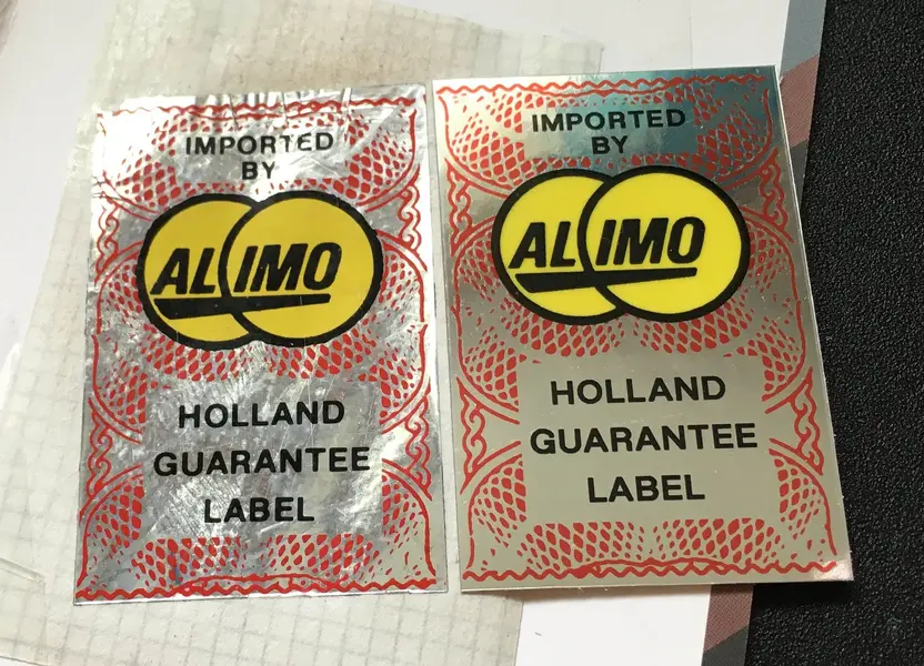

Thanks to @Prum who carefully peeled the original sticker off intact, I was able to reproduce the chrome "Imported by Alimo" label and get a batch digitally printed.
Here is a comparison of the original and reproduction, side by side and close up. You'd have to see two stickers in this situation to notice any differences but fitted to a bike frame I don't think you'll be able to tell that it's a repro.
