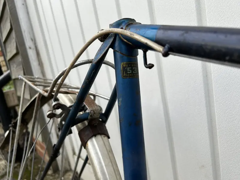

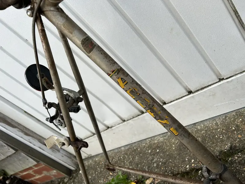

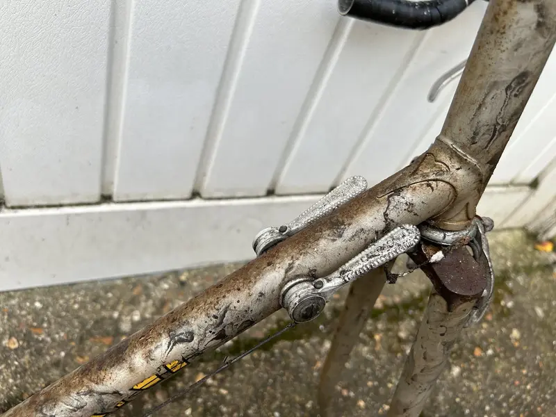

Our pipe freezing machine came up trumps for me again when it came to freeing the stem and seatpost on the Cinzia frame. Not so lucky with the Holdsworth - the stem would not budge in that one, might put it aside until a suitable set of forks come up.
Progress on the Italian though.
Seatpost was a Brevetti - I think 26.2, knackered now though. I have an SR in the right size or a Campagnolo one in 25mm which would work with a shim..
Saved this pair of vintage roadie frames from my local scrapyard this morning. Not sure of model year Holdsworth Hurricane 58cm and a 1972 Cinzia Adorni 60cm. Both also yealded some nice Campagnolo parts which will help make one nice one out of the pair hopefully.
View attachment 784142View attachment 784143View attachment 784144View attachment 784145View attachment 784146View attachment 784147View attachment 784148View attachment 784149
Both stems are seized into the forks and the Cinzia has a stuck seatpost - so some work to do.
Will probably focus on the Holdsworth as it’s closest to my size.
I paid £30 the pair, happy with that.
