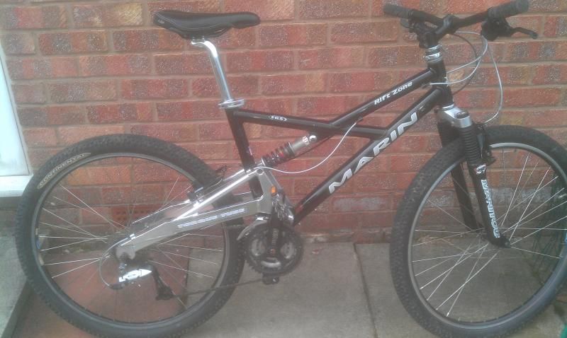

Last Saturday, this came home with me:
Isn't she gorgeous? I originally had one back in the day ( around dec 96 ) and I was dumb enough to sell it around 2000. I've been after one for a while, and although they aren't exactly hen's teeth, I have two disadvantages, being: a) Skint, and b) a shortarse.
Okay, they don't go for massive money anyway, but current circumstances meant that "not massive" money would really have to be "nearly no money" until things improve/
Being a shortarse just meant I would have to be patient.
And Lo, did a 15 inch Boingy Marin Appear on the bay of E for fifty quid winning bid, and there was rejoicing in Chorlton.
After winning it, the seller decided to tell me that the fork was seized. ( Not that this would have stopped me bidding, but it would have been handy if this info had been on the listing, still, it seems churlish to wish it could have been cheaper as a result )
She has been comprehensively mucked about with:
Wheels are from a Dawes, with a nine speed cassette ( Dawes hubs, Rigida Sphynx rims, Continental traffic tyres ) Truvativ cranks, Titec Hellbent bar, Kona stem, Deore brakes, levers and shifters, LX rear mech. Spesh saddle. Joke pedals.
The frame, fork ( Manitou Mach 5 Pro C ) seatpost and shock are all original.
The shock, though never the best piece of kit still works fine, still damped and no leaks, so no complaints there. Bearings fine, no play or wag, and no sign of fatigue or cracking anywhere on the frame or swingarm. Most of the bolts are rusty though, and it had bought a couple of spiders back from St Albans with it. :shock:

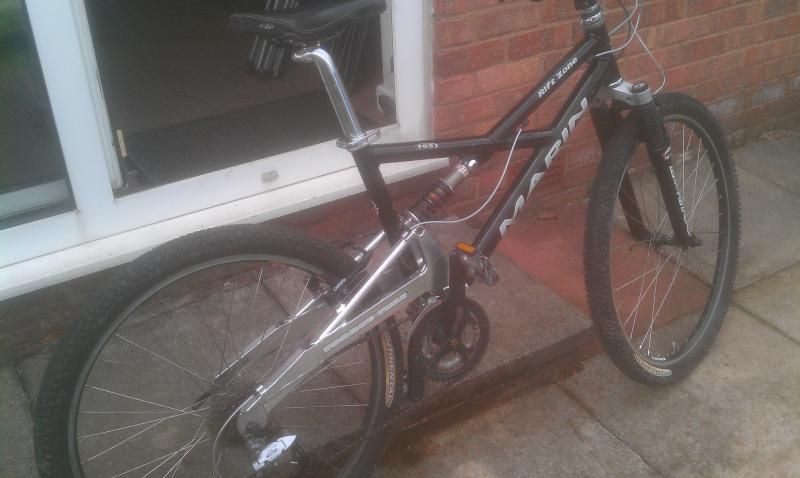

Here are a few more pictures.
