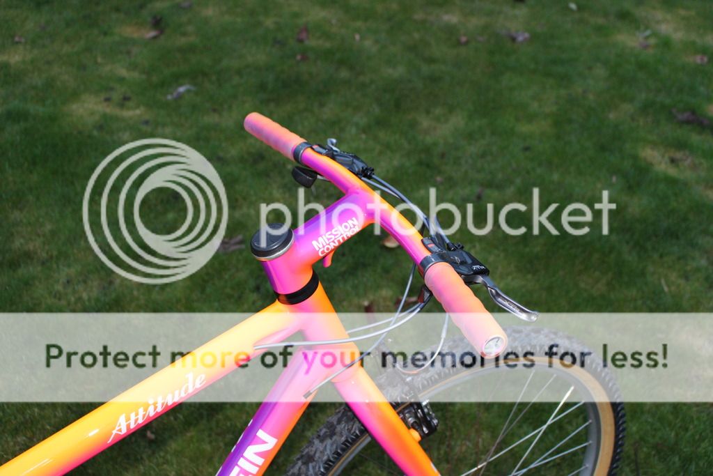

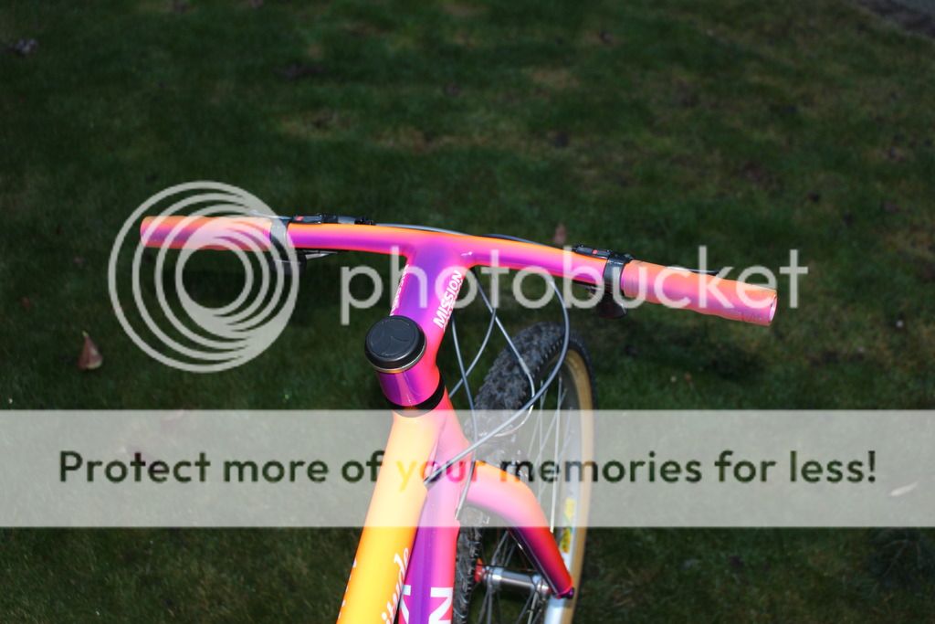

also looks like the forks are a little too long, I need to take off a few mm from the top - any advice on how to do this ?
I wouldn't recommend taking anything off the top of the fork. Klein designed the MC2 setup so that you mount the stem flush with the top of the steerer and you install black, circular plastic spacers underneath the stem to "absorb" the visual space. The typical MC2 frame uses 3 black spacers but I've seen some bikes with 5. The spacers are also designed such they help seal the headtube from the elements, dust, water, etc.
SF Klein":3tbwrzpc said:
Thanks for the advice, this is a better and safer option, I got a few spare spacers when I bought the frame, so I'll add one of those. The only reason was that the cap that goes on top of the stem doesn't press fit, as the stem sits a little proud, so adding a spacer should fix this - thanks for the tip !
Yup - if the steerer is proud of the collet that you tighten, then the cap will not press onto the collet nut. I think there were 2 top caps made for the MC2 system - one for mountain bikes and one for road bikes. The MTB is slightly larger in diameter. If you find your top cap still won't fit after squaring up the steerer tube with the collet nut, you might have a top cap for a road bike but this is unlikely if the top cap came with the bike you're putting together.

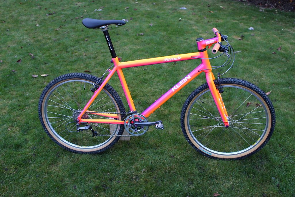

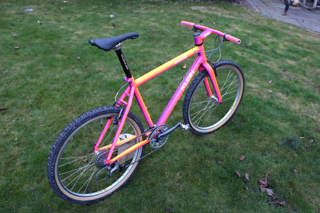

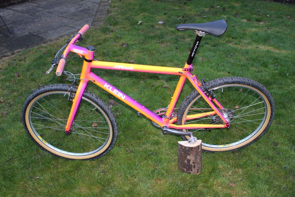

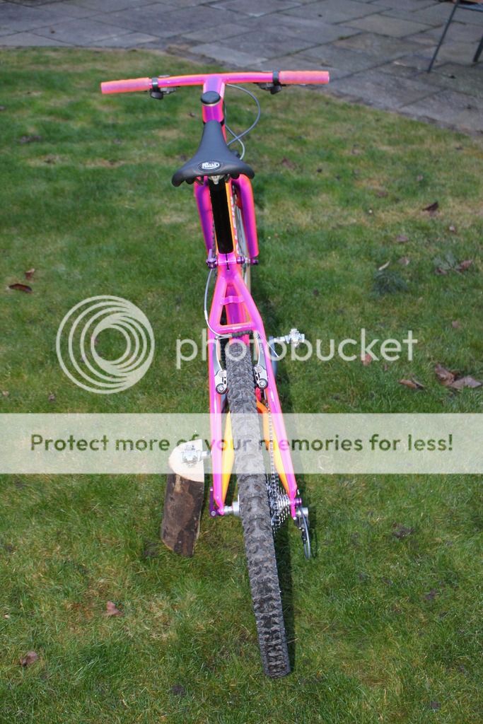

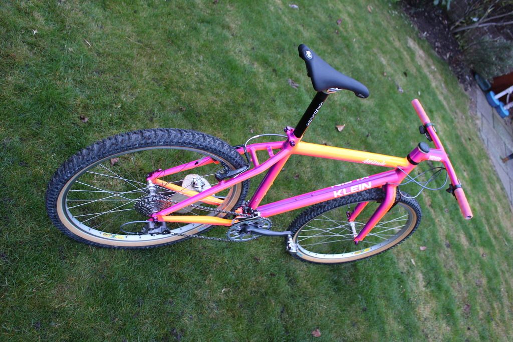

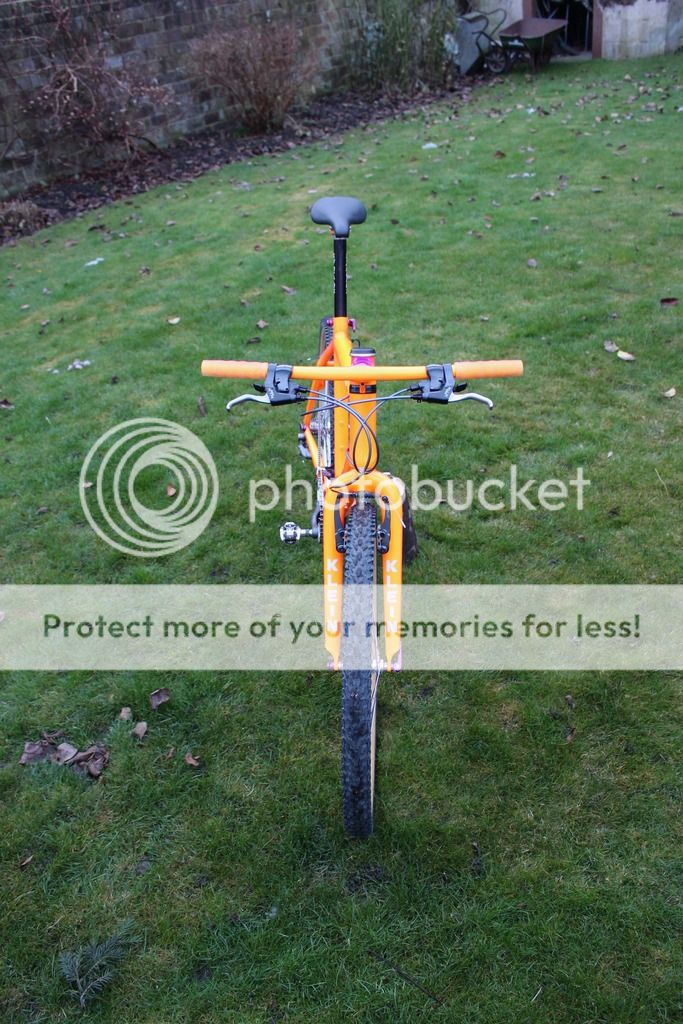

Finally it's done (although looking at this forum, I'm not sure a bike is ever done!), here's the photos of it finished...
I'm really pleased how it turned out, and thanks to my mate Mark for screwing it together so nicely. I'll do a spec sheet in a couple of days, but just enjoying having it completed !!
