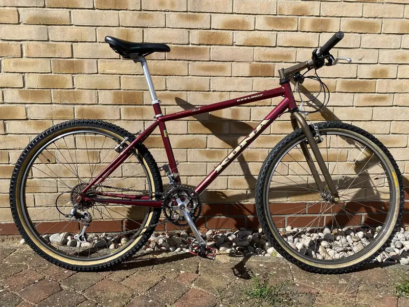

Background, after owning a new 92 Fire Mountain sold for a new 98 Kilauea ridden to near destruction, my recent return to old Konas was a 91 cinder cone which was pretty original so was really a strip and regrease.
What I always wanted was an explosif and fancied 94-96 with square decals as I hadn’t had anything like that before, so took the plunge on this which may be familiar to a few, with a view that it looked ok but knew that it was far from original.

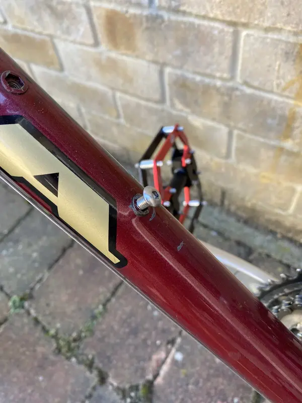

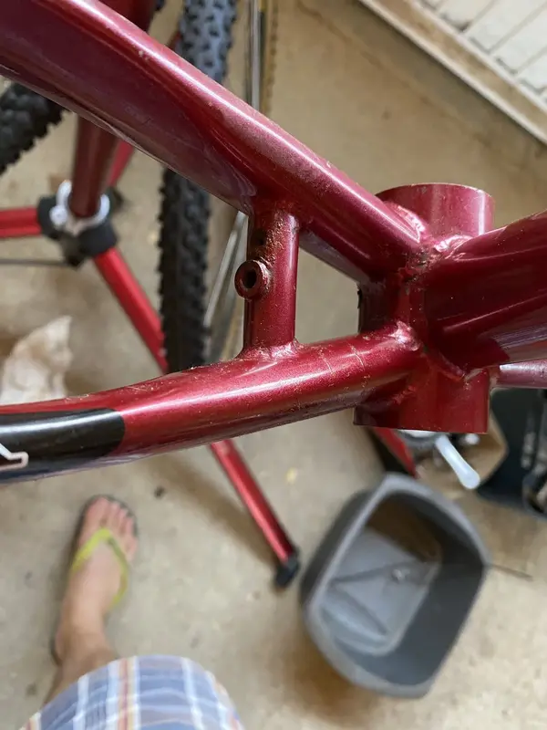

Upon closer inspection it was as suspected a hybrid with a lesser model with the Kona bars and seatpost being the clue but most importantly could only be an explosif with the awesome Columbus max tubing. Whilst the paintwork was mostly decent it wasn’t entirely, rust appearing in a few spots and a spinning rivnut with stuck bolt that has also pulled at the downtube. A52BEE01-40A6-4440-A82C-DF60A8E7AC6D.jpeg 916BEE09-94F6-4B21-9C5E-88877975DAB2.jpeg

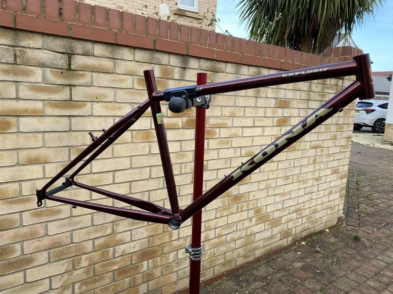

Got it back this week from Argos cycles looking lovely, paintwork isn’t quite demonstrating the depth of the metallic red in the November light… B83C835F-D53D-4F07-ABC4-D32AB924E717.jpeg

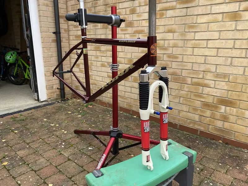

First things, the forks. No teenager ever wanted project twos in 1995 - look cool up to 93 models but from then on it was about the suspension. Also this one has the “mountain shock” sticker and as I’ve always had a dodgy hand from birth, suspension hurts less.
Always quite fancied some Pace, bombers are great (Kilauea had them) but I stumbled across a pair of NOS 97 Judy XCs so that’s my starting point, they’ve even got the brake boss covers on and internals have the original grease looking fine - the cream and red was also the colour I though looked the best.
Only niggle is that I’ll need to run v brakes through the dog collar...
Quick mock up

Yes, the paintwork looks amazing 😍
