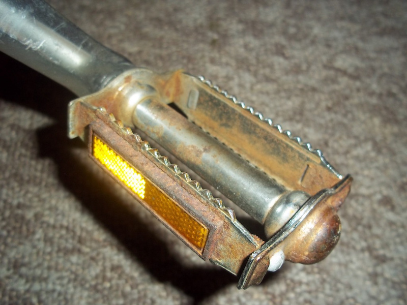

Hi Gary. what did you do to get your brakes that shiny? I want to get my parts shiney as new again but have no idea :?
Thanks.[/img]
Thanks.[/img]
hi kinetic, i'm not sure about the dulled brakes, but your shiny chrome pedals will come up nicely if you rub them with aluminium foil dipped in water. use a hard wax polish to shine up once the rust is gone. this has worked a treat on the succession of second hand bikes i have sourced for the kids.
