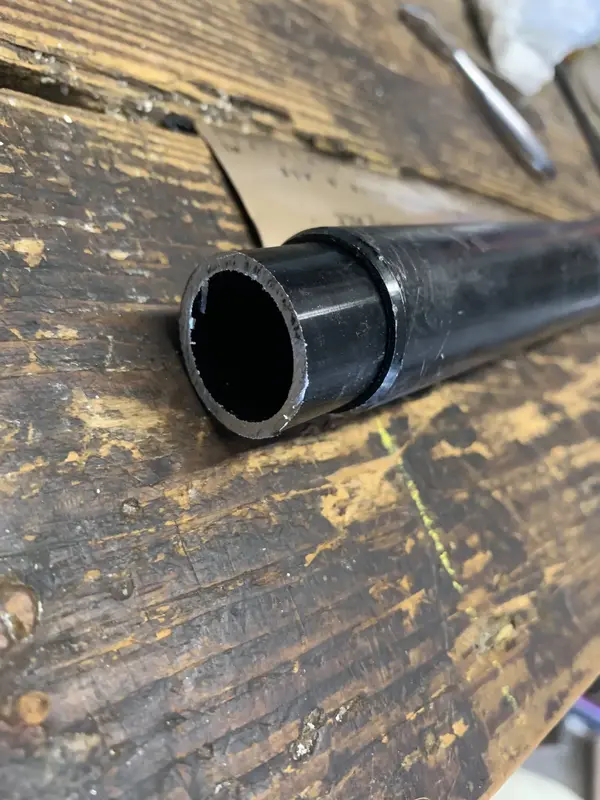

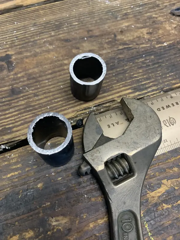

I had same fitment issue with my SP
I made a shim
Couple ways u can go here
Here is pic of what was final product was (and is) presently
The first option
Get similar size material for shim
I used portion of the SP that fit
Then honed out the inner portion at friend’s shop
Vise is critical, I used a hand held drill
The drill bit was cylinder shaped (like a can)
Then cut a vertical slit
i remember this took me hours to get perfect
