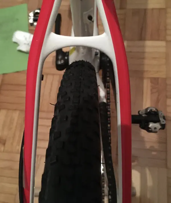

All 26 can fit a 27.5 “ with 650-42 tires … because they are near equivalent. If you buy some rimbrakes wheel set 27.5 you have to move the brakes too.
This is mine, a 27.5 gravel tire in a 26” frame. Lot of clearance:
