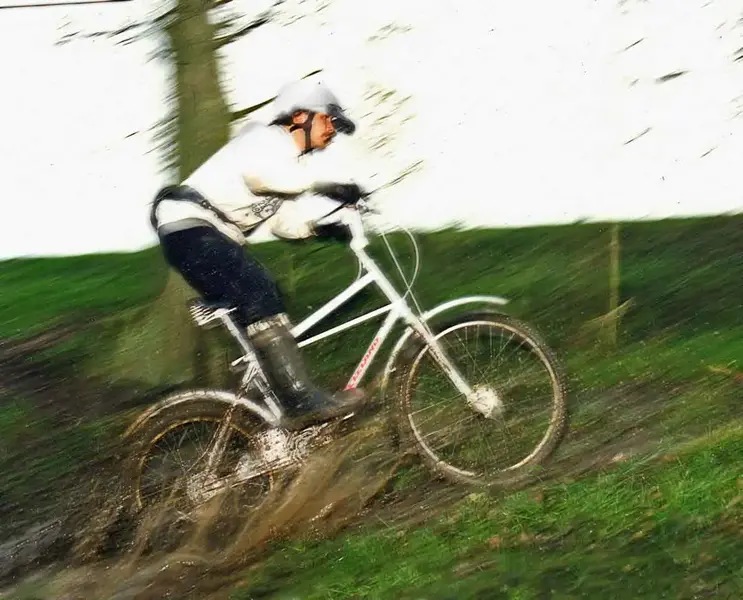

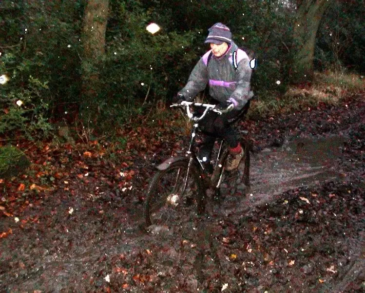

In over 20 years of off road riding in all conditions, I can honestly say that I can count on the fingers of one hand the times that its been so muddy and I've been riding so slowly that my drivetrain has ceased working due to clogging.
A/ we have lots of marl around here (a mixture of clay and chalk) which gets mixed into with standing water by the many horses to form a quagmire.
B/We ride in all weathers and all seasons.
C/ Because the bikes are not damaged by mud we actively seek out the best muddy bits.
D/ We share some of the local trails with 4wds and tractors so "wheel rut
riding is commonplace.

For fair weather riding you are correct, as much of the extra stuff is not needed including the frame clearances. Though in the UK, it can get very muddy even in the summer.
But in the winter the bikes need very little maintenance. Geoff Apps recently spent a week riding in Devon. He took no tools, not even a pump, did no maintenance despite keeping the bike outdoors in all weathers. In his opinion maintenance and repair means wasted riding time. My 1988 Highpath made Cleland is still running all its original bearings, has been heavily used and abused, and only gets cleaned once a year. Its rear brake shoes are original and the front have only been replaced once. Highpath say that one set of shoes will last for 20,000 miles.
The Clelands are off-road touring bikes intended to get you there and back whatever the trail conditions or weather. This could be a week of winter touring. They will keep the mud off the rider so that you arrive at the bed and breakfast in a presentable state and will not let you down in subzero temperatures when you have four hours of night-riding to the destination.
It would be foolish to use my carbon fibre Giant NRS in such conditions. but even if I did get to the destination the repair bill could be considerable.
Having said all this, I did feel that despite being made in Guildford, my Highpath seemed somewhat out of place in the bone dry conditions of the recent Leith Hill RetroBike Ride. Overkill: like a expedition spec Landrover Defender in Tesco's car park.
