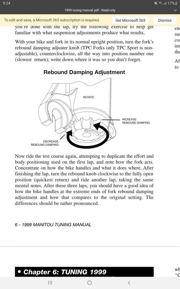

My forks are the sx-r 2001 model. 2 years older that those shown in your manual. The first picture is a screenshot from your manual showing what looks like my missing parts but is titled "rebound damping adjustment". My second picture is a snap from my fork manual and shows a similar shaped adjustment knob but it has a different title - Damper adjustment knob. Are these 2 visually similar parts but doing different processes?

Looking at the manual for 2001 it looks like a push in Allen key version (much like other forks use).
I would assume you don't need it, just plug it or use an Allen key to alter it when needed.
If a seal is gone, it might be one inside. Unbolt and remove the lower and similar for the top and elastomer and springs, see what's in there.
