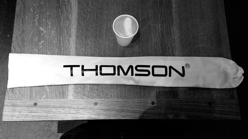

The handlebars are here. Can't show you them just yet, but they arrived in the biggest Thomson bag I've ever seen.
