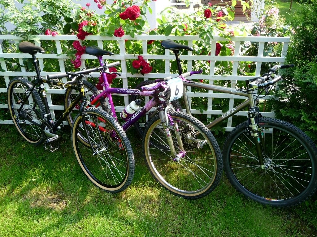

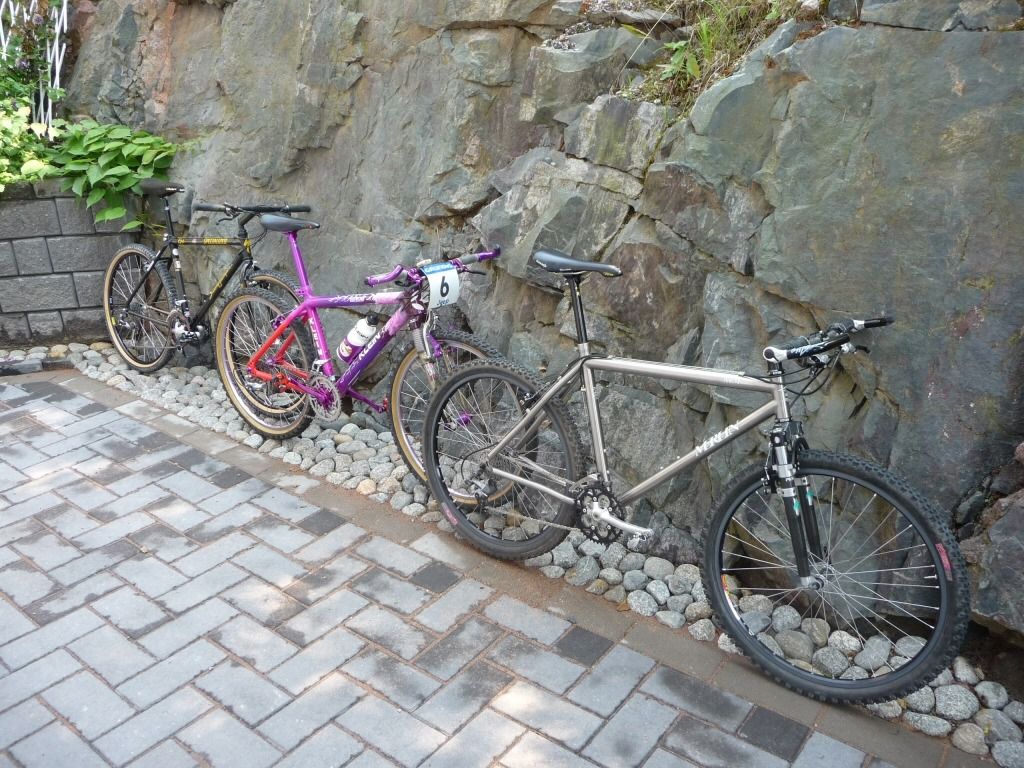

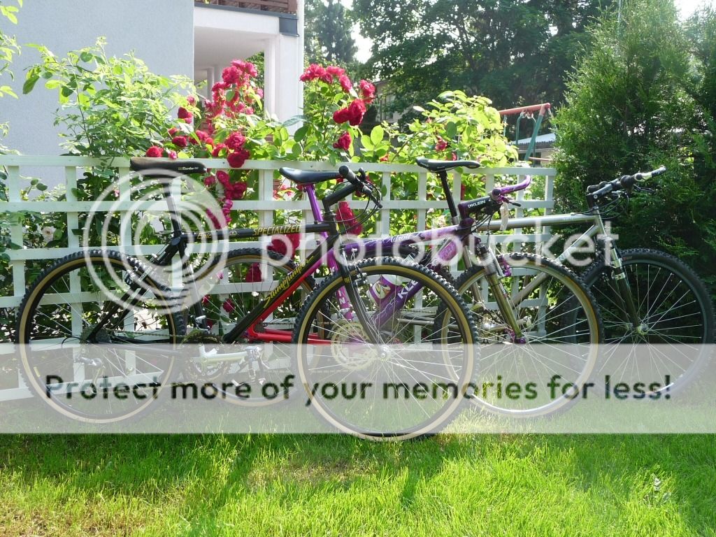

This might be my last? retro build since frankly, my storage space doesn't allow any more bikes than the current 3 (had to even sell off my '96 Klein Adroit). Since I now have a Klein Adroit, a Spesh Ultimate and this Merlin XLM, I don't have any reasons to complain if the number of bikes stays as it is.

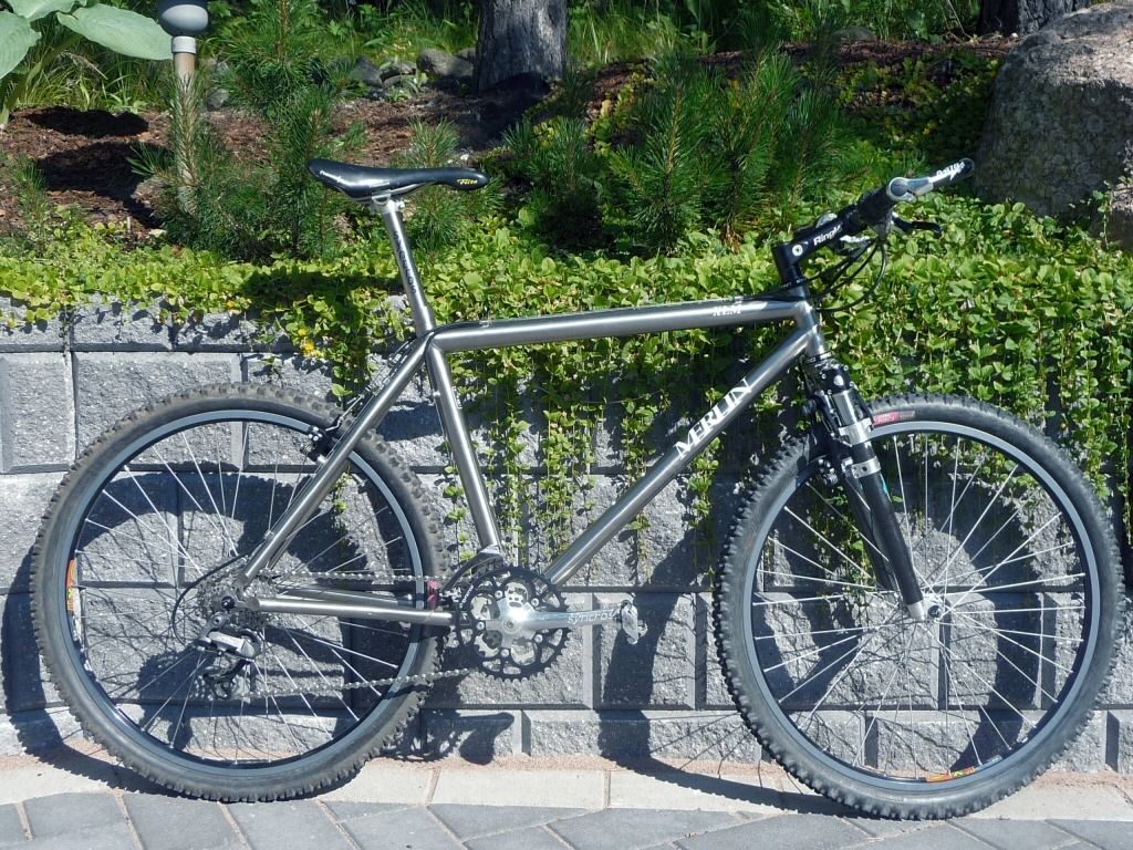

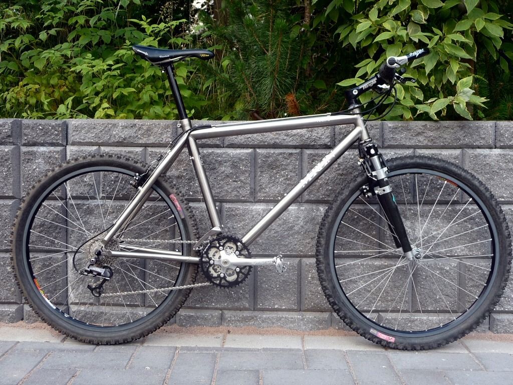

Anyway, back to the Merlin build! I think she turned out quite pretty and svelte too: 9,74 kg with Ringlé post (bit lighter with Syncros).

Now here's the bike:
Option build with Syncros Ti post:
Parts spec is as follows:
Frame: 1996 Merlin XLM
Fork: Pace RC35 MXC + Stage2, hydraulic damper & travel extension
Headset: Chris King NoThreadSet
Stem: Ringle Zooka Ahead 120mm
Handlebar: Merlin Ti
Grips: GripShift
Barends: onZa OZ-170
Shifters: GripShift SRT-800 X-Ray
FD: Shimano XTR M950 TP
RD: Shimano XTR M950
Cassette: Shimano XTR M950
Chain: Shimano XTR IG90
Gear Cables: Shimano inners + Tune outers
Cranks: Syncros Forged
Crank Bolts: Syncros Crank-o-matic
Chainrings: Syncros Hardcore 44/32/22
Bottom Bracket: FSA Ultimax Ti
Pedals: Shimano SPD M747
Brake Levers: Avid Ultimate
Brakes: Avid Tri-Align with Dia-Compe pads
Brake Cables: Shimano inners + Tune outers
Seatpost: Ringlé Moby Post
Saddle: Selle Italia Flite Transalp
Front Hub: Pace RC-50XC
Rear Hub: Chris King Classic
Spokes: DT Swiss Titanium MMC
Nipples: DT Swiss Aluminium
Rims: Mavic X517 Ceramic
Rimstrips: Maxxis Flyweight
Skewers: Ringlé Twisters Ti
Tires: onZa Racing Porcs II Kevlar 2.1"
Tubes: Maxxis FlyWeight
black Ringle post, even though the Syncros is Ti. Balances the build better with the forks. ;)
