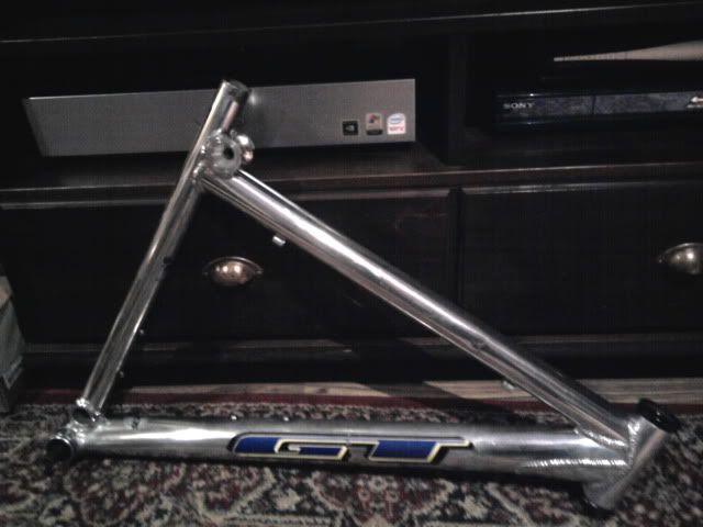

I've finished stripping my frame this weekend, and have been polishing the front triangle :shock: :shock: ( also a 16" LTS)...
Please excuse crappy phone pic!
Weird...
A race to the finish then Barney? :LOL:

HA! I work Slooooowww... Winner comes last? :LOL:
That pic makes it look better than it is, LOADS of autosol has been used already.
I'm really enjoying watching your progress, and thinking how we are coming to similar decisions on things...
