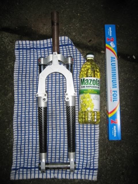

I hope to restore the overall lustre by polishing with Canola oil and aluminium foil on damaged areas and canola and a soft cloth on undamaged areas, then I will move onto Mother's or Meguiars chrome polish with a soft cloth to finish.

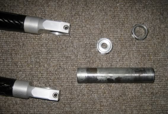

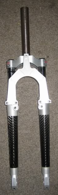

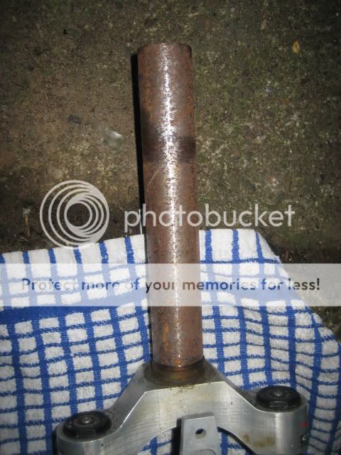

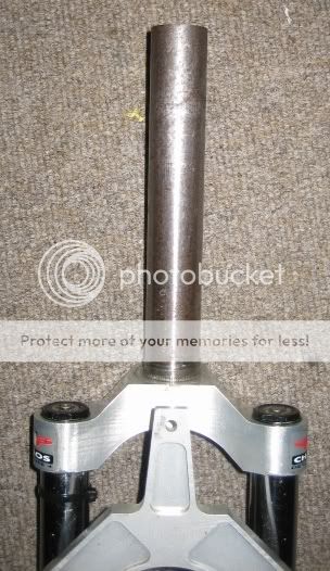

I started cleaning my forks today, I haven't finished because I didn't have long, but it's a start.
Before...
After...
