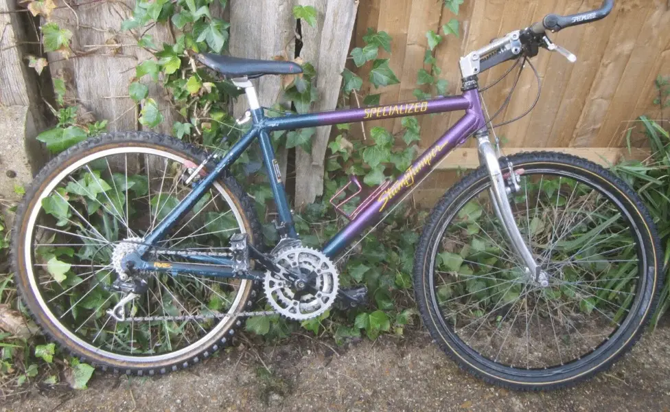

Not much original on this one, but a great frame colour and era
Original:
Chainset, front and rear mechs, maybe seatpost
Left side brifter, right side brake lever
Non original:
Forks changed for Orange ones ; original would have been 1 inch threaded rigid
Suspension stem - could that be a threaded steerer, if not then headset changed too
Bars
Right side shifter swapped out, maybe this is now 8 speed as original would have been 7 speed
Brakes, tyres, wheels
pedals
Saddle
Bit all over the shop indeed spec wise but could be a good project that if the price is low.
That stem is a pukka Softride version and definitely a quill fitment. They're becoming worth a few quid on their own these days :)
