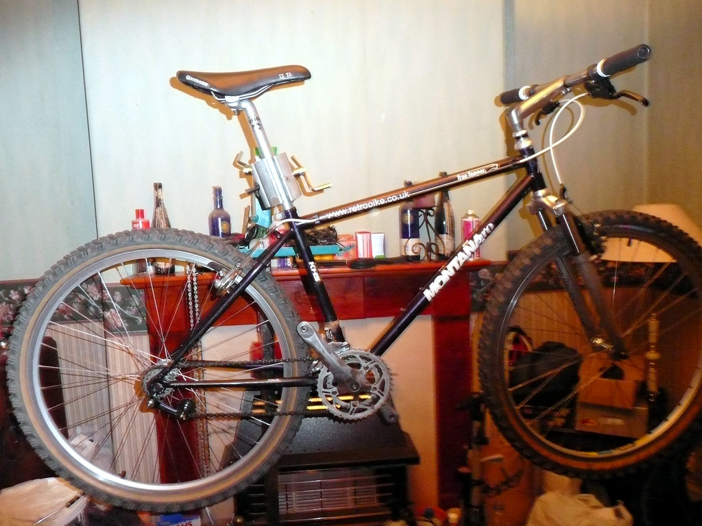

1993 KHS Montana Pro, virtually catalogue spec :D

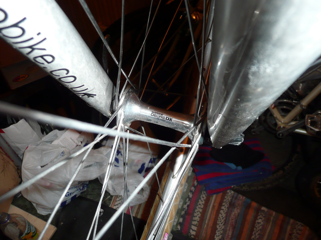

Update with DX wheelset, with customary shoddy pics too ;)
Spec list
True Temper OXII tubing
Mag20 fork with Mag21 canti bridge
Zoom stem
Amoeba Titanium bars

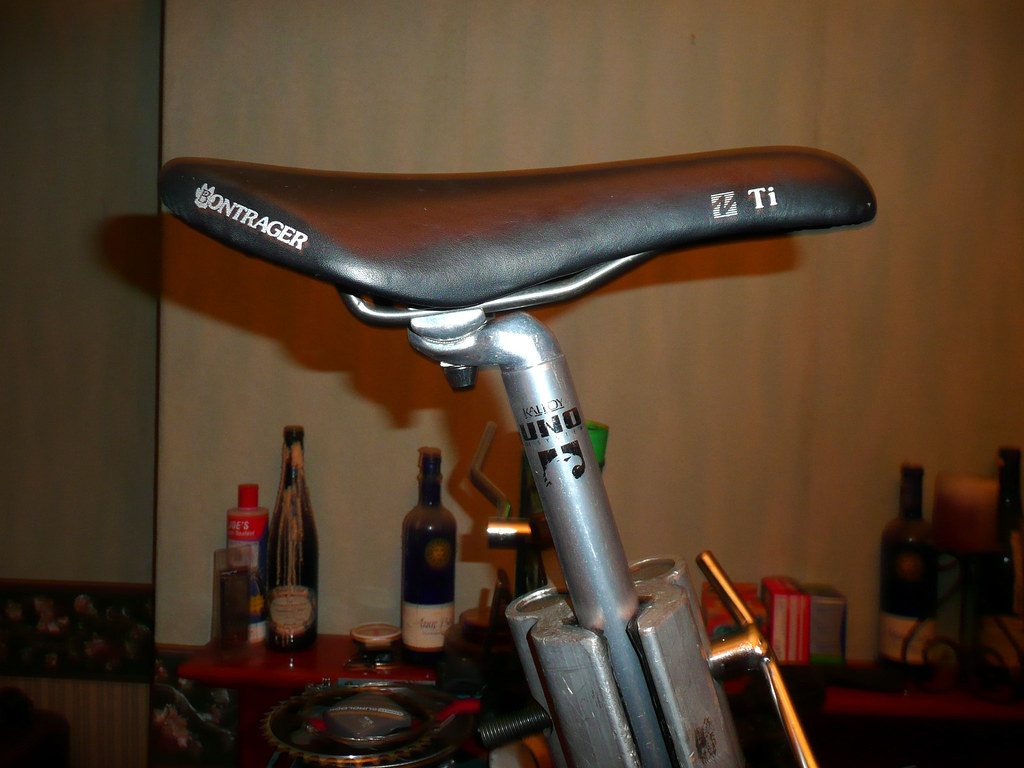

Cube sponge lock on grips
Kalloy Uno seatpost (date stamped 07.94)
Bontrager Ti saddle
XT M736 front mech

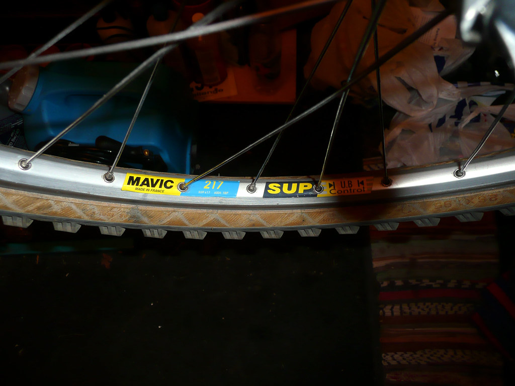

DX hubs with Mavic 217 Sup rims with DB spokes
Chainset & rings TBC (To Be Changed...)
Alivio canti brakes, gave the front one a quick polish & it's come up quite well, very M900 ish lol
M095 brake levers with shifter pods removed for now (until M735 rear mech arrives)
Tioga Psycho 1.95" tyres TBC (To Be Changed...)
Clarks white outer cabling and silver ferrules
No pedals on this build yet.

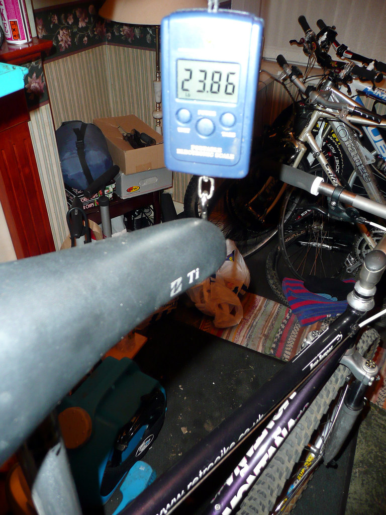

Sub 24lb :shock: mind you that is without pedals ;) and a lighter much shinier chainset that should be on the bike soon :)

I want that saddle and post. Fancy a swap for my right arm?

The old wheels were quite heavy, the tyres are I suspect wire bead and pretty heavy too, it's now back to it's original fighting weight :LOL:
With flat LX pedals it still comes in under 25lb (24.7 IIRC), that'll change once I re-gear the bike though, depending on how singlespeeding goes...
New wheelset has regular supermarket special tubes in them, I might get some lighter ones sometime, and I've just ordered some (brand) new 1.8 tyres for it ;)
Just has a quick spin round the block, very nippy & quite nimble, although a little flexy, the bar has plenty of trail buzz killing properties judging by how soft the front end felt, I think it might be a rather nice bike to ride ;)
Had trouble popping the front end up as I'm not used to the stem length being longer than on my other bikes :oops:
Think I am under geared with the ratio I have at the moment, but that can change with either the chainrings I have coming, or the sprockets that I already have.
It's 34/18 at the mo & I was spinning out quite easily on the flat, I will try 34/16 later and see how that goes, although my hilll climbing skills may require the 34/18 :(
Brakes kinda work OK, but with a bit of squeal from the front, but no major issues, can pull skids, so what more do you need :LOL:
Rear hub sounds a bit dry, I'll investigate this later, runs smoothly with no play so probably just a regrease & it'll be as silky smooth as the front hub
Once the cranks & rings arrive the frame will be thoroughly cleaned & a good coat of Autoglym polish will be applied, the rear brakes will be stripped down, cleaned & given a quick polish to match the front brake that I had a quick polish of a few nights ago.
Headset seems to be ok after loosening the nuts off a tad, I will strip, clean & inspect it later before cleaning & final assembly
