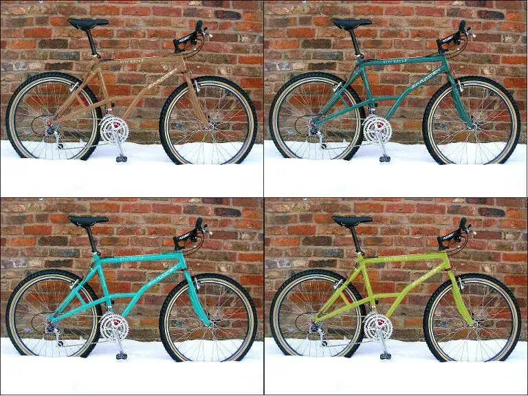

Crikey.. at this rate, I'm going to have to nail down what colour to paint it before the weekend! :shock:
edit: I edited a photo to try and test different colours (I think the original was by drystonepaul). It's only a vague representation, but I think I'm down to these colours..
I think it's between light brown or lime green!

Well, my opinion is that all the colors you picked are nice, the brown is real nice, but I think that should go on a classy bike, your frame is sporty and different, not so much classy. So being sporty that rules out the forest green color, its not flashy enough. The lime green color is a good choice to end up with, but out of the four colors you picked, the teal, bluish green color is perfect, it catches the eye and compliments the frame.
Pretty much same colours I'm choosing between on mine. Bit Skint as August is an expensive month so mine might have to wait until September for paint.

I'm unsure about the brakes.. I have Deore DX callipers, but no levers. I do have some anodized blue Tektro levers and callipers, however. They're a nice colour (not sure if they'd work with whatever paint I end up with), but the levers look a little cheap, and I've heard the callipers are a nightmare to set up. I'll have to try them out, and buy something else if they don't work out.
As for colour.. Up until this morning, I was still leaning toward brown, but then I looked at the bikes in the bike rack at work. About 25 bikes.. 20 of them black, 1 white, 1 silver, 1 red (mine!), and 1 green. Maybe brown is a bit too boring.. :roll:
