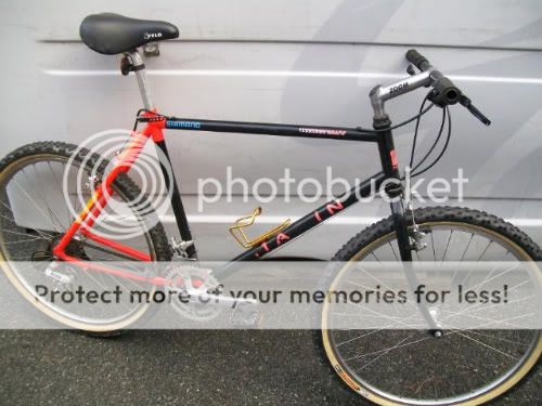

My mate bought this bike about 8 years ago, and it's been sitting in my shed ever since, so a deal was made and the bike is now mine........

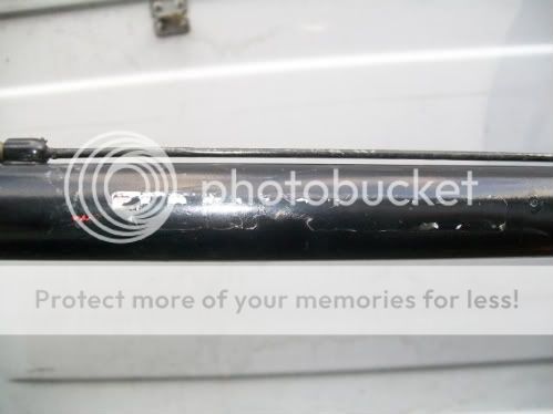

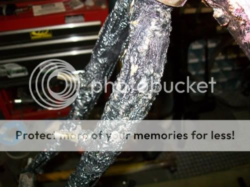

The stem and seat have been changed sometime during its life, and the black paint on the frame has been touched up by brush. A few spots of rust were also coming through, so I decided to strip it completely.

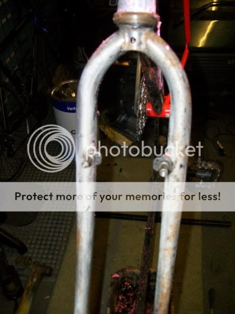

The bike was put in on a stand and all the old stickers were peeled off, stem removed, complete with front and rear brakes and derailleurs, the seat post and stem, chain and chain rings. Nitromors was then used to strip the paint off and cleaned with wet - and - dry and scotchbrite pads.
After the frame and forks were stripped, they were degreased and painted with 3 coats of etch primer, 5 coats of colour and 5 coats of lacquer.

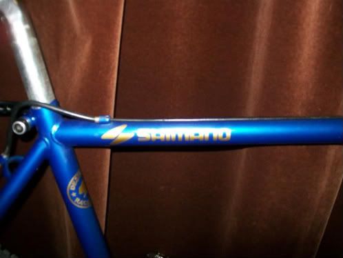

I found a company on eBay that made stickers for Marin, and a set was bought for £11 inc delivery. The only thing thats missing are the "Eldridge Grade" ones on the top tube.

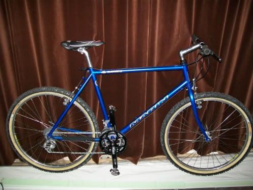

So........what's the verdict???
There's only one colour for a rally based bike - Subaru World Rally Blue Metallic :D
The bike ride went very well with around 20 of us taking part, and over £4000 was raised in a forum / auction on the night for the 2 charities.....
Lovely finish on the paint fella. Looks nice.
If you are keeping it long term for aesthetics I'd go for a shimano chainset but like you say, for timing etc that was fine.
Goog build mate, and congratulations on the fund raising.
