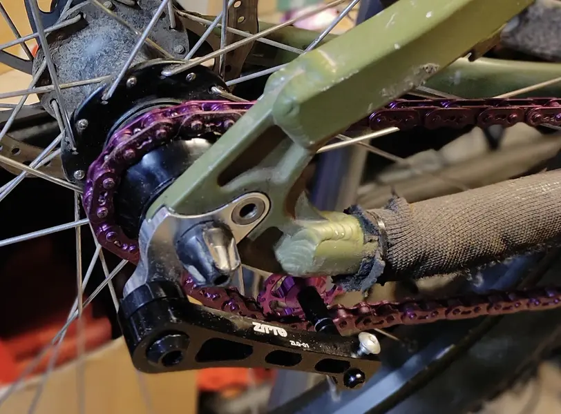

Looking purple-er. Pretty much done now, just want to rebuild the fork if I can find new seals. The chain skips on the rear sprocket a little under heavy load, I want to blame the shitty chain tensioner. To be investigated.
Time to go re-learn how to jump!
Looking at this pic I wouldn’t be laying the blame of the skipping chain at the door of your chain tensioner, looks like the chain isn’t dropping right down into the teeth and engaging correctly. 👍🏻

Suspected the cause is the chain not being wrapped around the rear sprocket enough. Attempted to solve by reversing the chain tensioner to push up rather than down, but there is too much slack in the chain for this to work. Taking out a whole link would make it too short, and I can't fit a half-link chain due to the narrow-wide front chainring... Took some time to think this problem over while I sorted out the brake.

The eventual solution to the chain tension issue - change the 30T to a 32T chainring! It's very nearly a Magic combo, and has solved the chain skipping.
