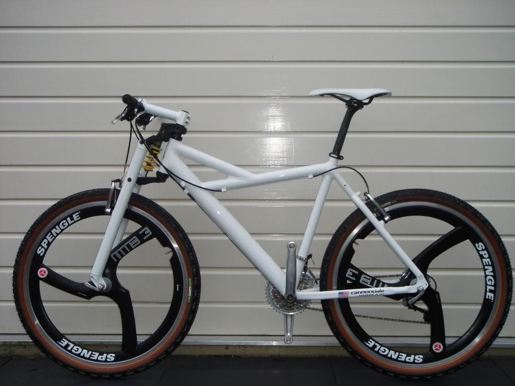

I`m going for the frontsus, Noleen carboncrosslink and spinergy`s. I`ve another Delta V frame with a 1 1/8"steeretube. :LOL: It`s going to be like this one(third killer v :oops: )
with the acception that it would be polished :cool:
