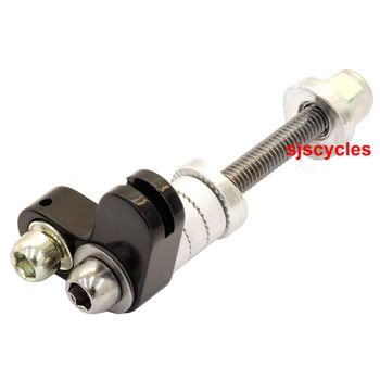

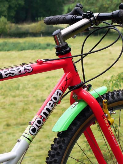

You could always get one of these from SJS Cyles...
...for you front brake hanger dilema; have them on three of my bikes...
Yeah, I know that's just two but you get the idea :cool: .................Much neater, and more robust.
