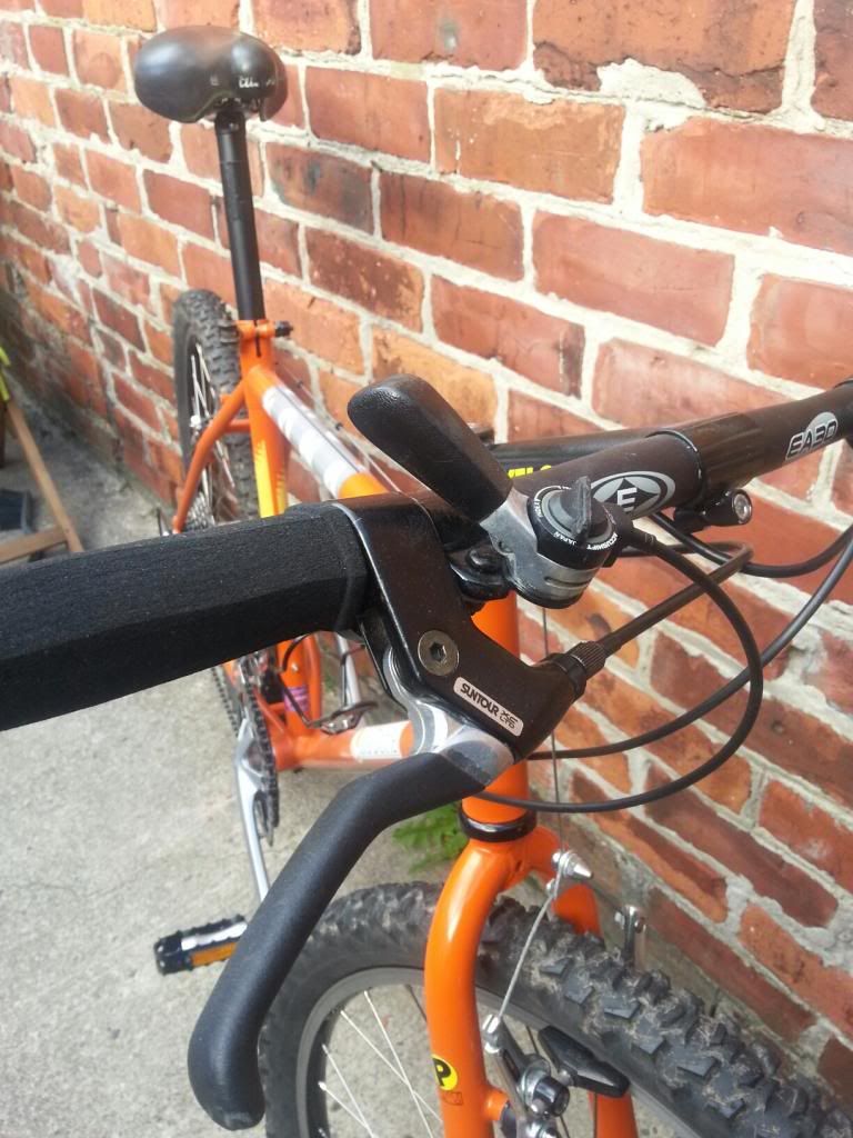

Couple of updates as few parts arrived durin the week,
Un55 bottom bracket
Shimano chain
Dx hubs laced to araya rm17 rims
Shimano cassette
Bottle cage
Zmax tyres
Just need pedals and cable up and she good to go. Dying to go out on this, will still be on the look out for some suitable suntour wheels, but for the time being this'll do.
Thanks, I like the xc ltd, however temporally pairing up with a shimano cassette may be interesting :shock:
Back in the day I had a 1990 cindercone with xcltd grouppo and I liked it back then, next project is a 1990 cindercone, bought the frame and forks off here, but an gonna splatter dx on it.
I have the cables to fit this afternoon, ordered a new cable guide for under the bb off eBay last night as forgot about that !
Not happy with the white joe murray sticker on the top tube so will try to sort that out, maybe a silver post I am thinking but not sure yet, and think that's about it :D
Then out for a spin...........
Well all sorted and went for a short ride today and I have to say was awesome. The shifting was good and accurate, and the bike felt lovely. Well pleased with it and can't wait to take her out again. Some pics --
Roll on the next project, a 1990 cindercone :D
