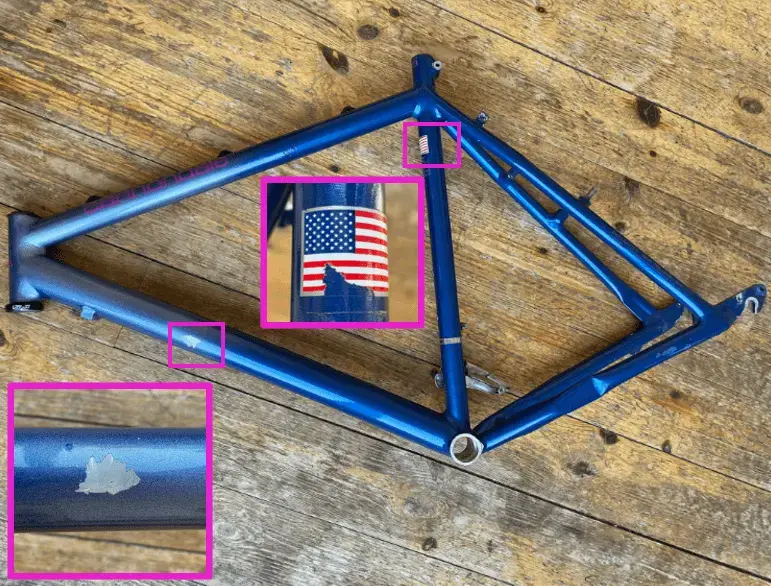

I have decided to build the first Cannondale M series MTB with Pepperoni fork - the 1990 SM2000. Came across a frame in decent condition with some major paint chips, planning to restore it :)

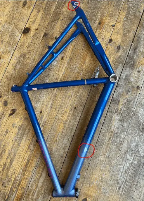

Here's the frame - large chipping on the down tube, but thankfully no dent:

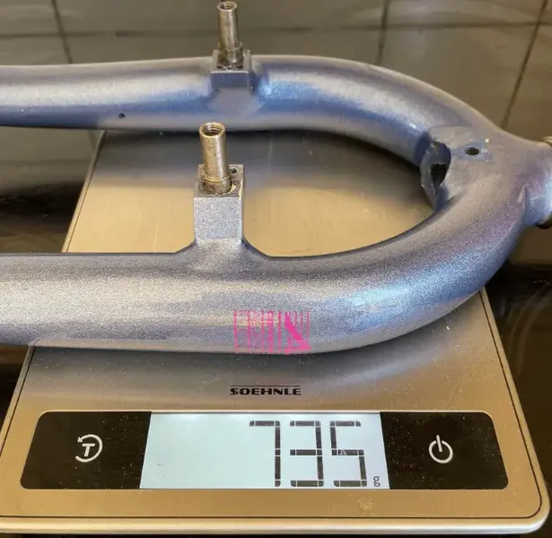

The fork was much better preserved - and super light :)

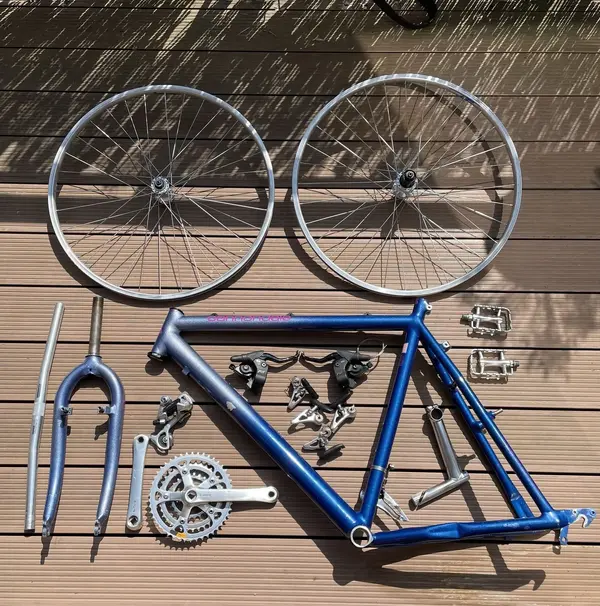

Some of the vital parts arrived: straight from Texas, a very rare Cannondale 285 (Nitto) stem in the ultra rare Aluminum version - 120 long, and the absolutely perfect length for my usual reach:

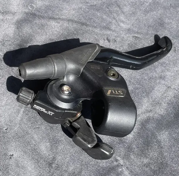

Also, the 91 XT shifters, the very first of their kind, cursed by design though, are here:
They are heavy af:

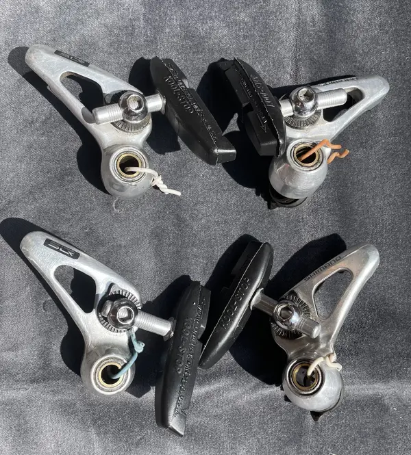

And the brakes:
And of course this classic:
The hunt is almost complete

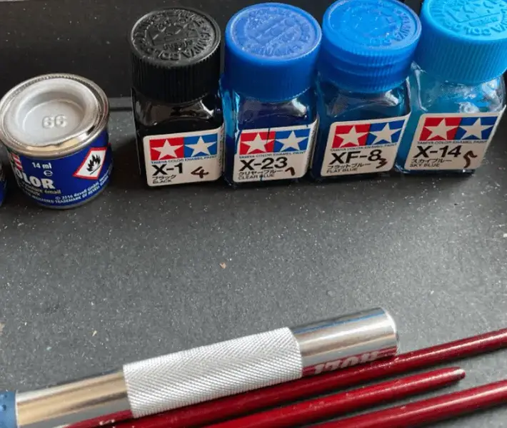

A good aluminium foundation and model colours are the way to go:

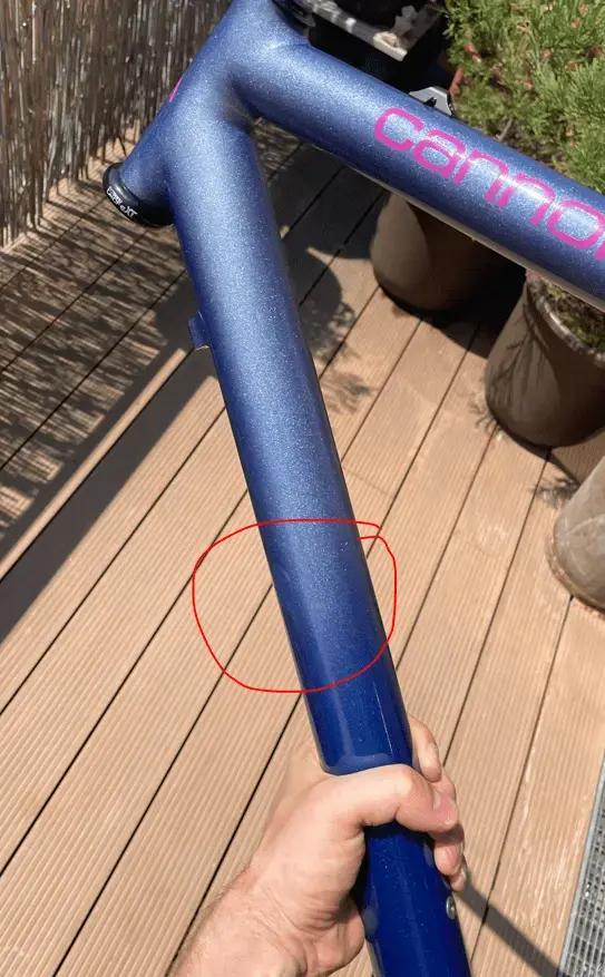

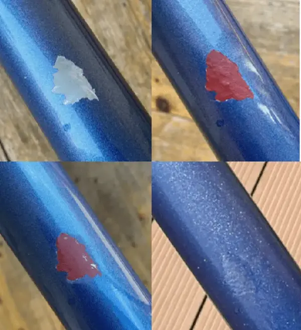

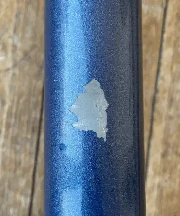

First, treating the large chip on the down tube - right at the transition of the overlaid metallic paint, unfortunately:
That worked:

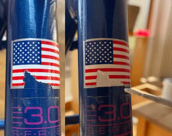

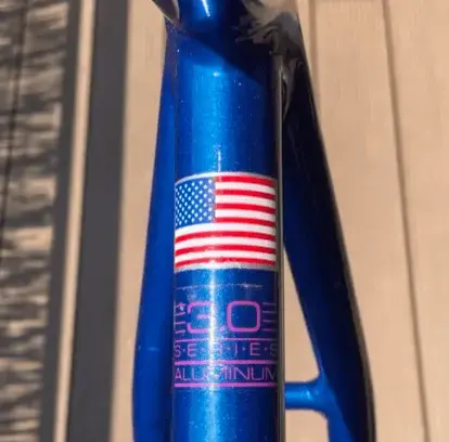

Then, the easier part: repairing the decal of the US flag:
The result is not stellar, but decent:
Finally, just a slight retouch of the printed logo on the very rare stem:

Nice touch-ups. Assume you flatted the primer prior to the top coats?
Interested to know how you did the metallic matching with them Tamiya paints. Did you stipple the various blues together to create the depth/colour variance. Also did you apply a topcoat over the top?
I used to use Tamiya paint to custom paint parts of my bike including the body of my derailleurs. Used to work really well, but no doubt the formula will have chance since the early 90s
Keep up the great work! 👍💪
Thank you :)
Yes, I applied several layers of the primer, (miss) using it as a filler for the scratches on the aluminium tube, and sanded it down before using teh model paint.
The way I did it was to mix the metallic blue base colour (I used two different colours of blue/metallic blue to achieve matching results with the rear part of the frame) and apply it.
After the base metallic blue was applied, I essentially had a dark metallic area inside the brighter transition area. Then I applied metallic spakling paint on top with a brush in tiny dots, until the overall colour matched the transition area.
I could have simply unpacked my Revell airbrush from 20 years ago for a better result, but I was too lazy to do that ;)
Thank you :)
Thanks for the explanation. You certainly did a great job and I kinda like you can still see repairs on an old frame.
I think the airbrush could have turned into a bit of nightmare with setting up, masking and cleaning. There's always something that doesn't quite work as it should when it's 20 years old.

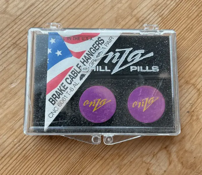

The goal was a original spec bike with some added colour. So I felt I needed to incorporate these outrageously colourful accessories:
Ready for the assembly :)
