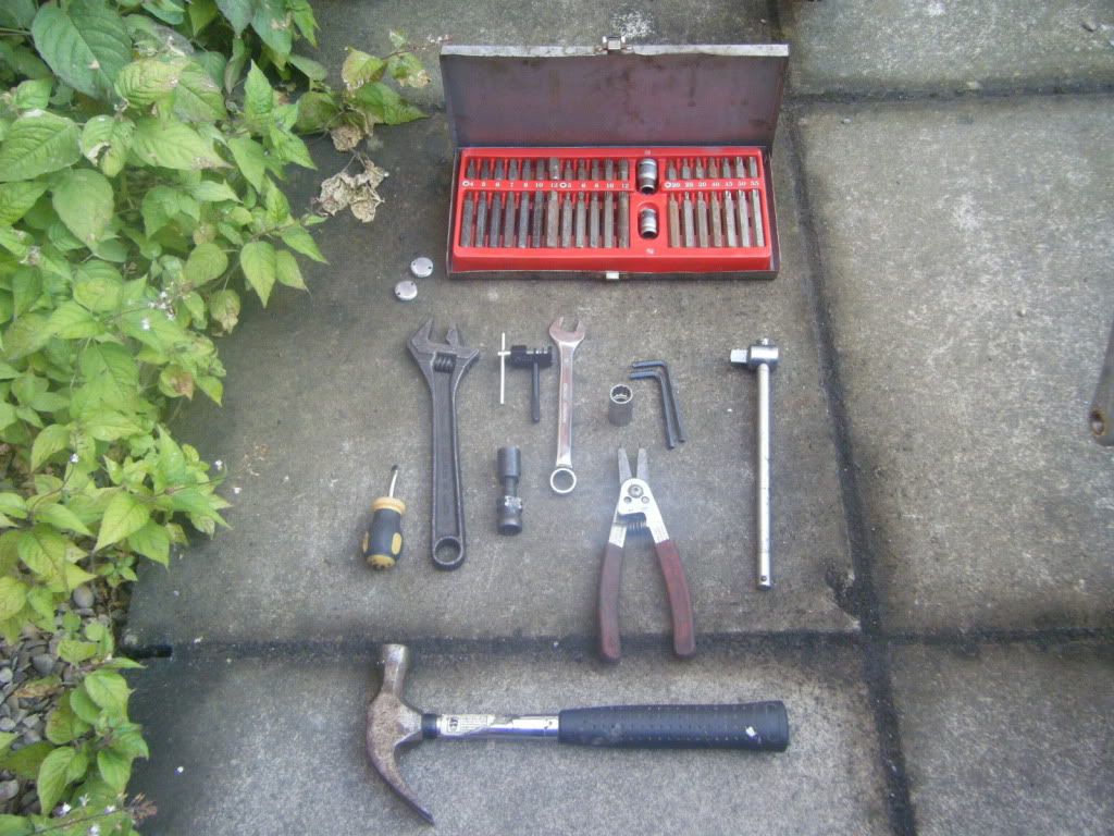

Tool time:

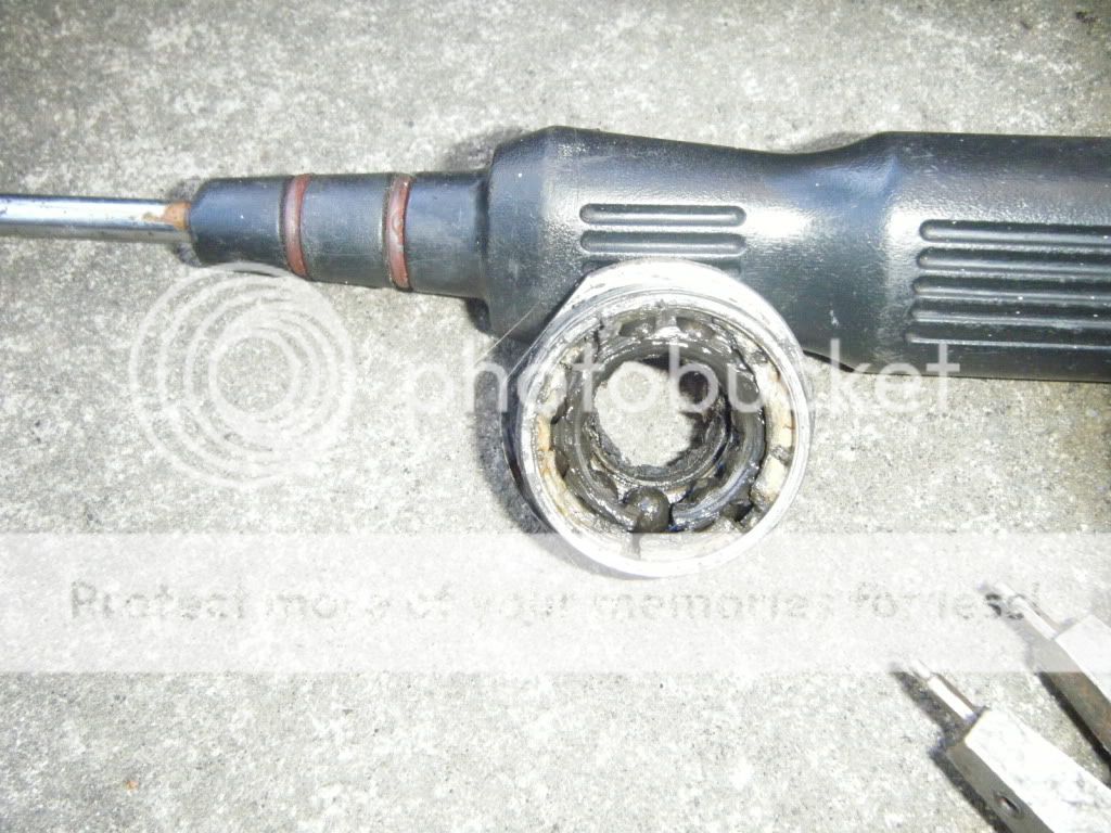

By lucky hap my super duper circlip pliers are a perfect fit for driving old XT adjustable BB cups

I'll bet any cup and cone BB bearing I can get now won't be up to snuff so I'll reuse the balls and replace the cage...

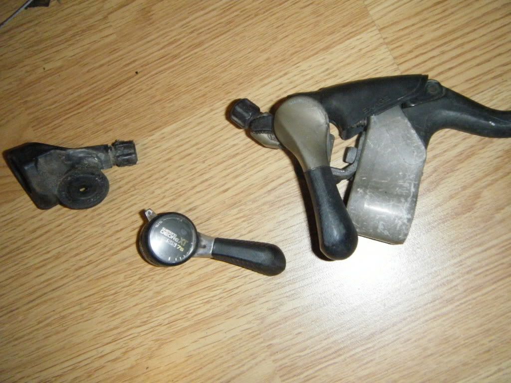

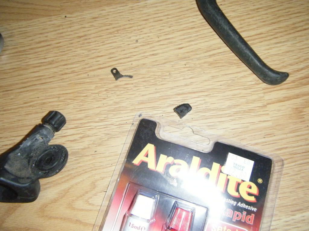

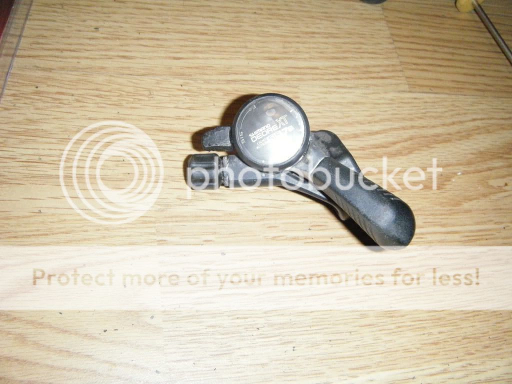

The index/friction lever has no cover... Ouch! better fix that - Here's where never throwing anything away comes in handy

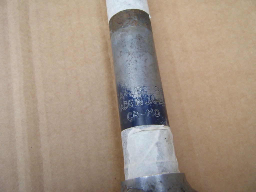

Seat post is well corroded, looks like the stuff you see on boat propellers!
More rust, just starting to get a real good hold... It wouldn't have been long... Months I reckon before the F&F was rotten

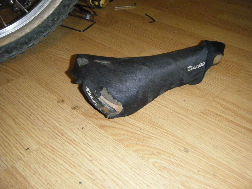

Look at the saddle:
Never did like Lycra!

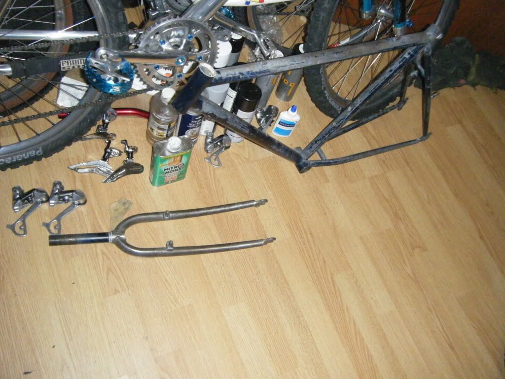

Then the fun abruptly stopped. Nitormors could not/would not eat the paint
This is after three goes. The last time I actually left it so long I had to wash it off
BTW I did it outside, not in the house as the pic may lead you to think!

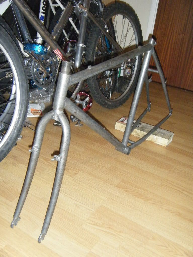

Bummer man! So I had to scrape the frame, the bits that hadn't been exposed to much Nitormors were easier as the thick paint was sort of brittle
Oh My God!!! I'm nearly done! I did over two evenings, it was hideous

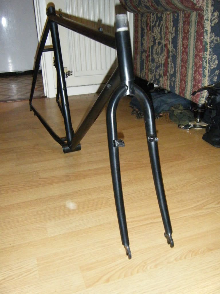

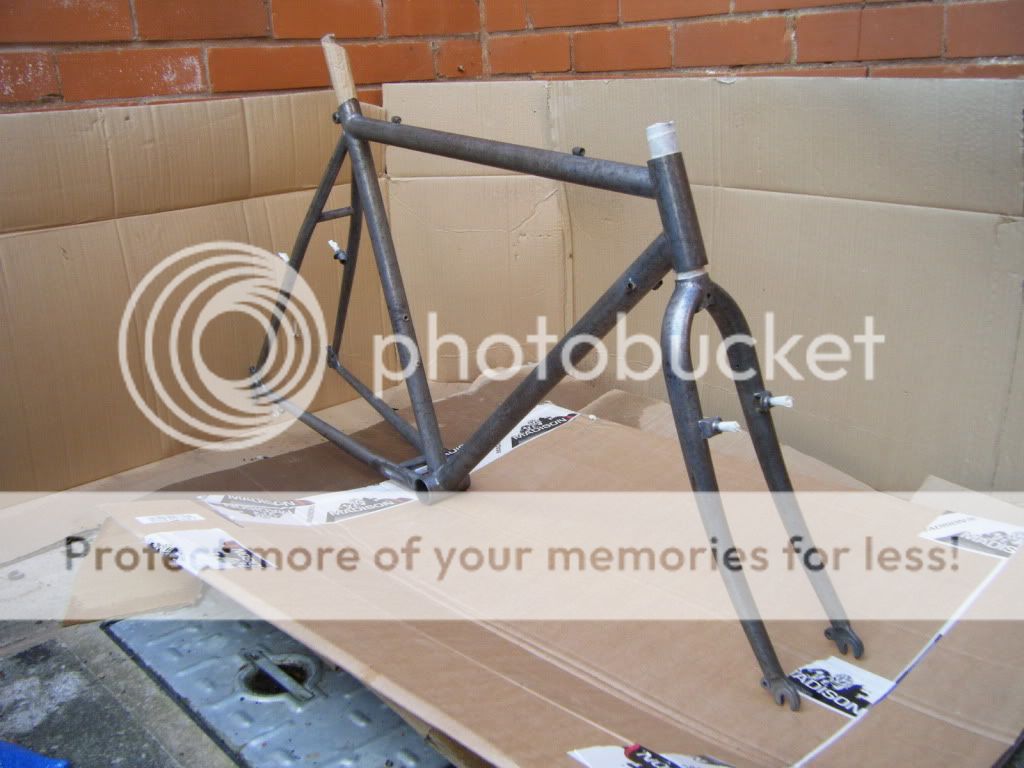

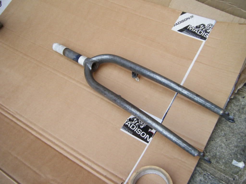

I'm done! She's naked, look:
After a lot of sanding:
Cool forks
She's ready for paint

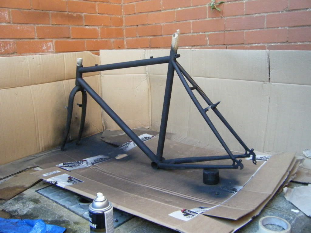

I used 'Rustoleum' as a rust cure and primer in one, never tried it before, it just looked and sounded the part. Can't recommend it more highly, went on smooth and laid up thick without running or sagging
I did this over two days I left out the under side of the BB and the chainstays, then after 24 hours I did those last bits
Plenty of coats!
I fashioned a means of suspending the frame and the forks in my chamber of semi assembled retro bikes, while the paint hardened
A quick wet and dry and then the same deal with the 'colour' coat I say 'colour' cos isn't black the absence of colour?
Ready for decals which I'm not doing by the book (catalogue) There it is! I always have to do at least one weird thing per build
Anyway Gil_m (who else?) Is on the case
If you wondering why the paint is flat, that is because on the decals go on I will do many coats of clear to get a crazy deep shine :cool:
