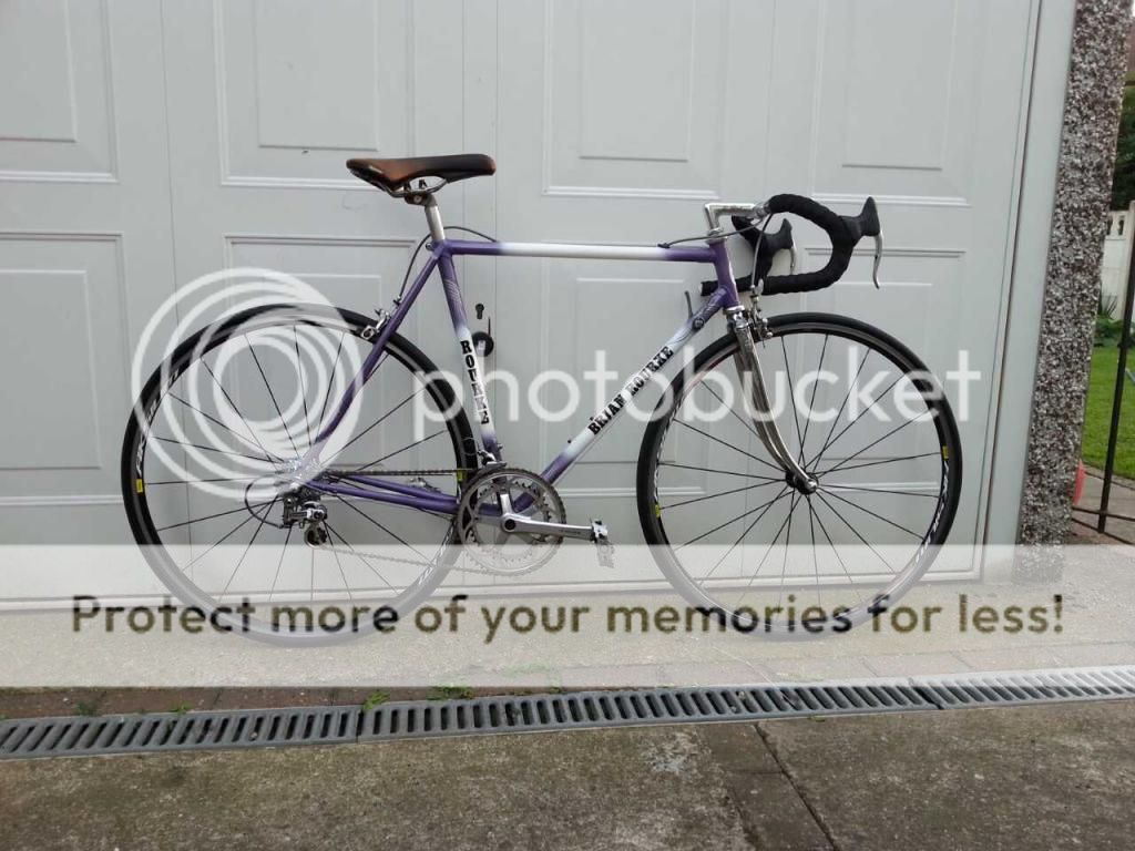

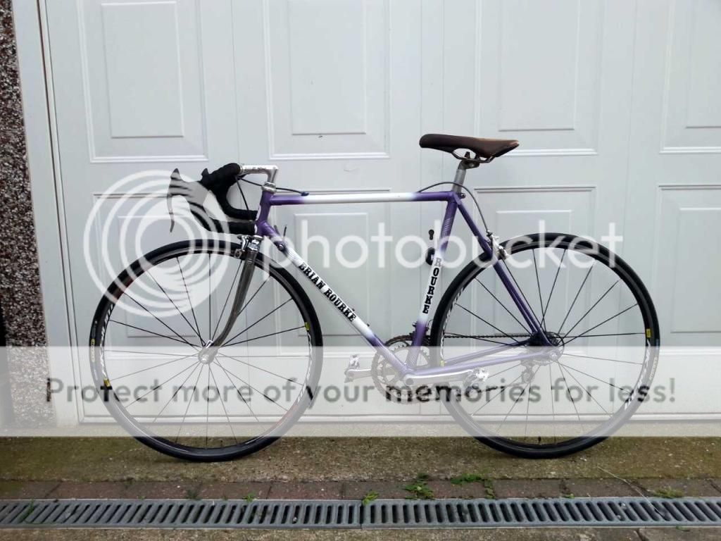

New wheels :)
New wheels on, I need to tweek the headset & sort the seat angle out. The bars will have to be swapped for a modern compact shape as I can't get used to the drop to the levers.
