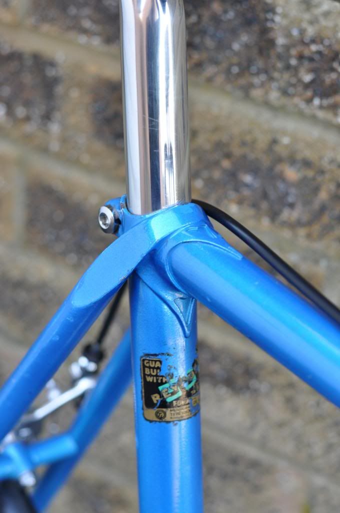

Cheezy decal hiding a scruffy bit of paintwork.

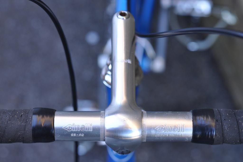

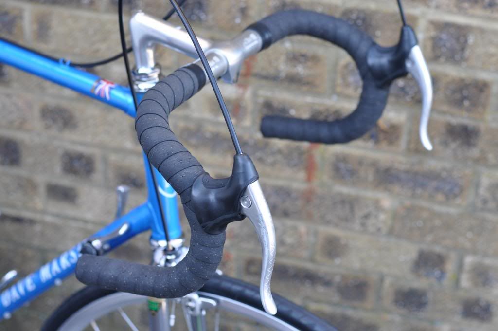

Bars n’ Levers.

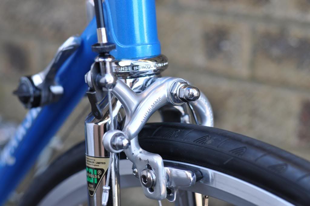

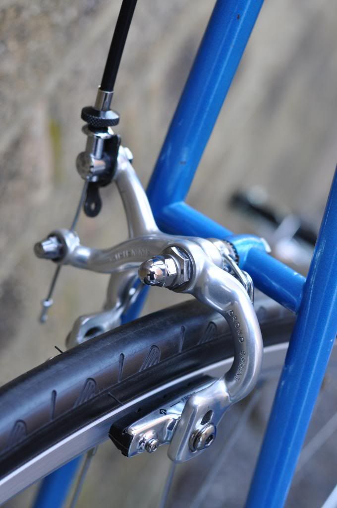

Brakes.

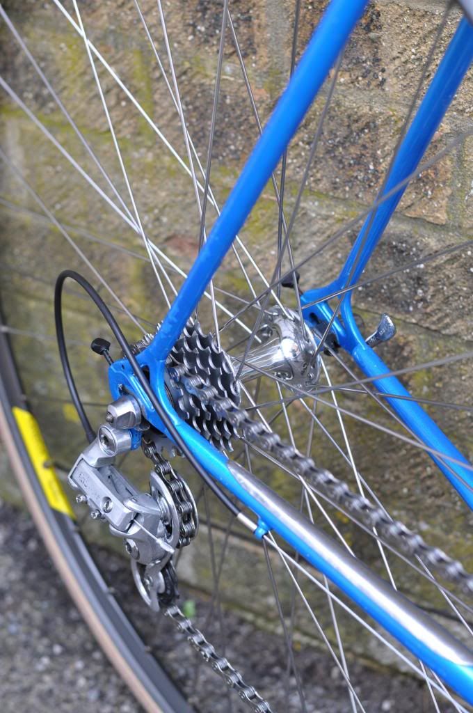

Rear Mech.
The Suntour Cyclone MkII didn’t have a cable adjuster when I got the bike, couldn’t find any evidence on google to suggest they ever had one, maybe it pre-dates index shifting ?
I made one up from a Campagnolo adjuster and an outer brake cable ferrule. Works a treat, no way I was going to be able to dial in the index shifters without it.

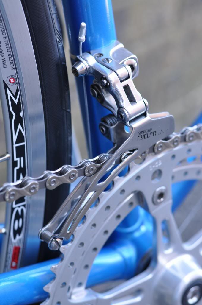

Front Mech.

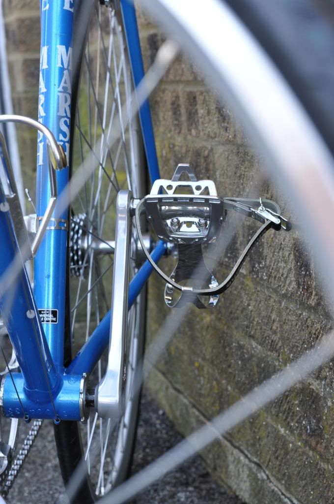

Crank Set.

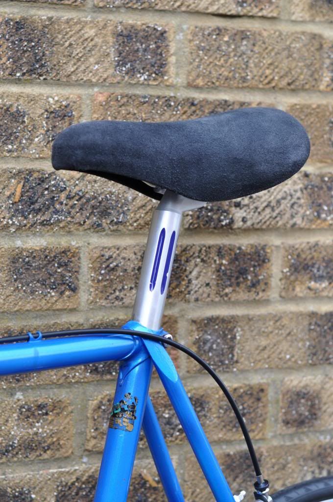

Few extra bits and pieces, Campagnolo Omega wheelset and a SR C-81 fluted seatpost, the finishing touches :D
