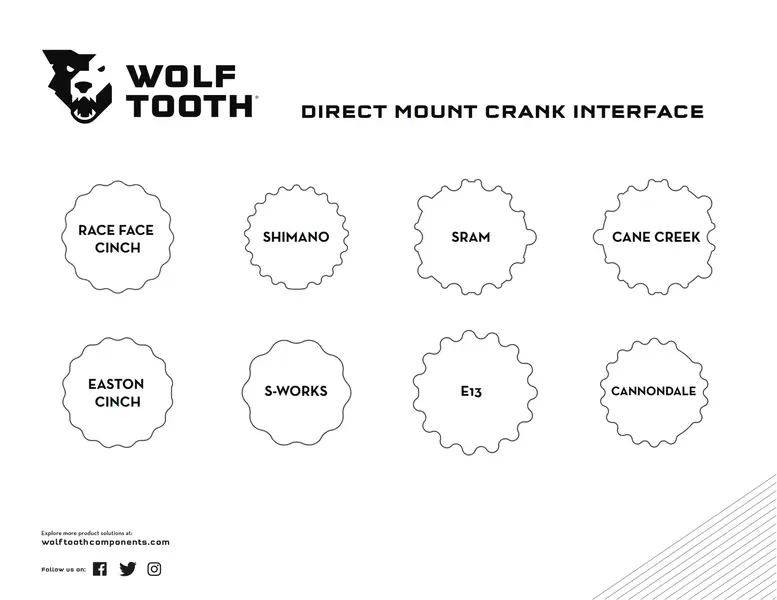

To answer your question, you can now get both symmetrical and asymmetrical 104mm BCD chainrings.
Along with a plethora of other "direct mount" chainring interface standards:
Screenshot 2023-02-19 at 14-30-53 Direct Mount Interface - Direct_Mount_Interface.pdf.png
