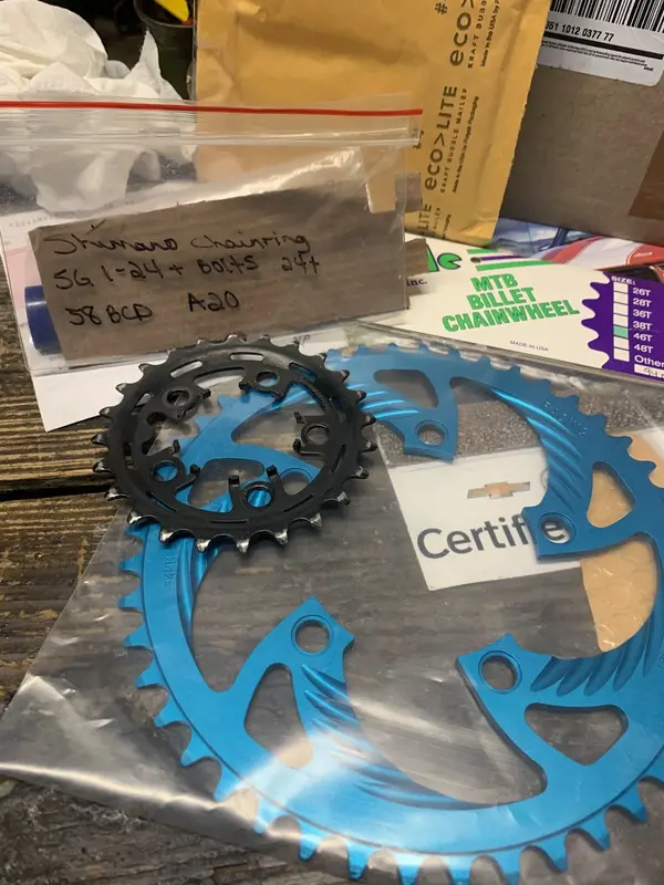

Sorry, more help needed
(I don’t have a crank puller and after days of trying to adjust rear mech….I took to bike shop to have both done)
So shop says
That granny gear 24t and outer gear 46t will work
But the middle 36t one will not despite the correct BCD

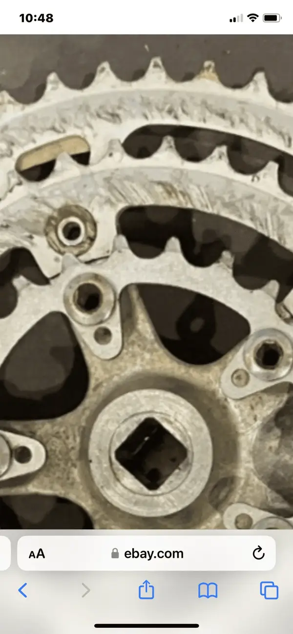

Explained to me(and I saw the minor difference) that the BlackSpire chain ring has 2 lips on either side instead of 1 lip and a ‘ramp’ on inner side
Ring for single speed (per say)
“Front mech (XT pull down) wouldn’t shift out of middle ring”
Can anyone confirm ?
These are best pix I found to explain ……
Lip
90 degree cut
(This is on both sides of the middle ring in question)

Like I said I saw/felt the difference
But after 30mins with tech, he got that this is 30yr old bike and limited options available to keep gearing
He will try to install and shift and report back to me
Any opinions?
