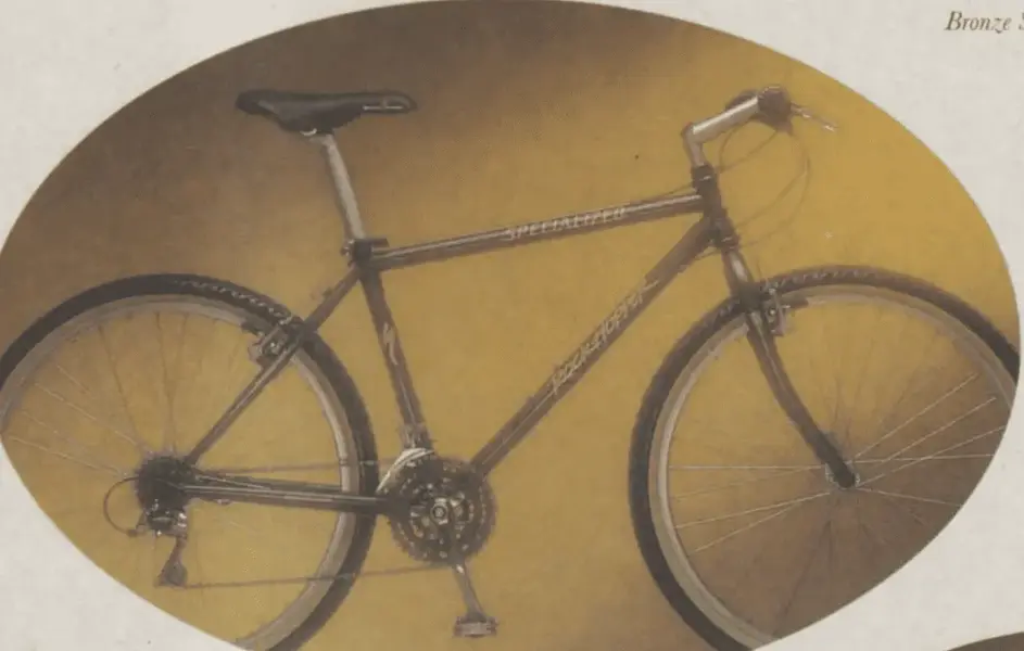

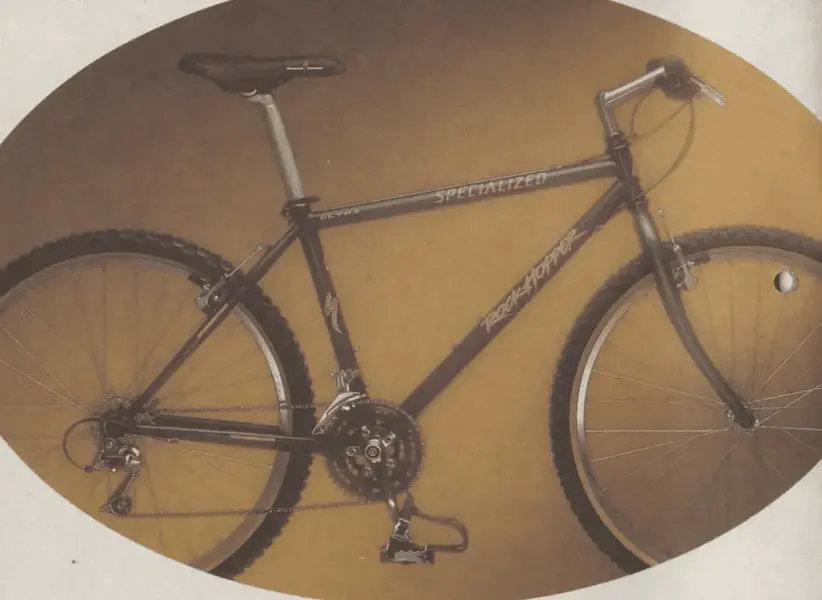

Thanks for everyone’s help. So, the consensus is 1995 Rockhopper? The frame seems to match up. The forks though. On mine, where both fork tubes come down and meet the wheel spindle holder plates (sorry, don’t know the actual name of those), that lowest part of the tubing is curved. I found this 1995 Rockhopper on eBay:
On this, the tubing is squared off, not curved. Is it possible my frame is fitted with different forks? Also, my forks look a little thicker, more heavy duty.
The forks don't necessarily help much when dating the frame, as they are easily changed. Could be a different year, model, or even manufacturer. Supply could have run low and they did a batch of bikes with different forks. It happens.
Alternatively, it could be part of the reason for the respray...
There could be any number of reasons for the forks being different...
