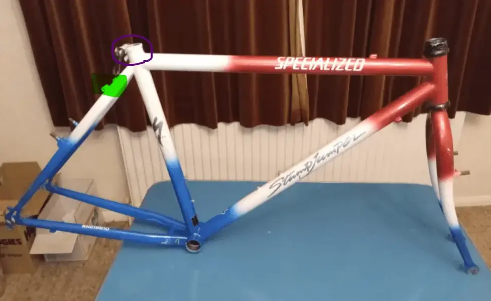

“Stumpjumper” frame - or is it ?
Repacker
Specialized Fan
Definitely resprayed, but the seat stay rack eyelets were a Rockhopper not a Stumpjumper feature by the time Specializeds had the cable noodle.
Yep, probably a Rockhopper looking at it with those rack eyelets. With those rear dropouts it's probably '93-'96 :)
well...
they cant all be fake!
Ahh.. but I think the OP was referring to the mounts on the seatstays and not the dropouts ;)
As an aside, is that Team frame the one on Ebay being sold for squillions?
Definitely resprayed, but the rack eyelets were a Rockhopper not a Stumpjumper feature
I’m the eBay seller of that frame. I was just going by the name decaled on the downtube. As soon as I discovered it might not be a Stumpjumper, I pulled the listing. I’ve been told that if I include some more detailed photos, some knowledgeable folk here, might be able to ID model and year? With the respray of this frame, the frame number isn’t easily read, but I believe it’s: P 436356
More detailed photos:
Could you provide accurate measurements of the frame too?
Seat tube - centre to centre then centre to top
Top Tube - centre to centre
The weight of the frame and forks might help too.
These could all be used by the groups in these forums to compare with our / other Rockhoppers and Stumpys of that era to help narrow this down.
By the mid 90s the Stumpjumper serial numbers began with the two digits of the year rather than a letter. Not sure if this was the same for Rockhoppers.
I think judging by the fact it's got a threaded steerer and rack mounts, it's more likely to be a rockhopper.
Stumpjumpers were threadless at that point and shouldn't have rack mounts
