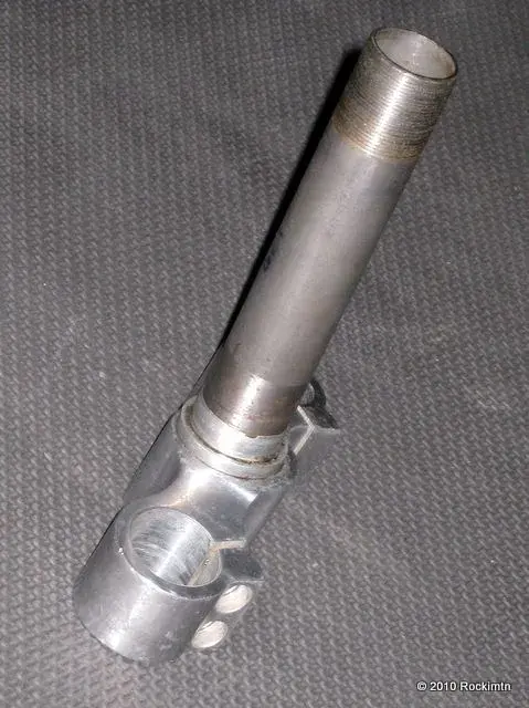

I have 1" Powerlite fork I'd like to use for a build. The steerer is too short (for use with a lovely Ti threadless stem), and I want to convert it to threadless. :twisted:
I can
a) attempt to press out the old and press in a new. highly unlikely due to cost and sourcing someone that's experience enough to do a proper job of it. also i've been told it's not a straight forward job as the steerer isn't 90 degree with crown since the fork legs are straight and the steerer/crown makes the offset.
b) cut the steerer and have it extended (sleeved/brazed/welded?). also probably not an easy job to source someone who can do this properly to keep the old/new steerer sections straight.
Am I committing sacrilege?

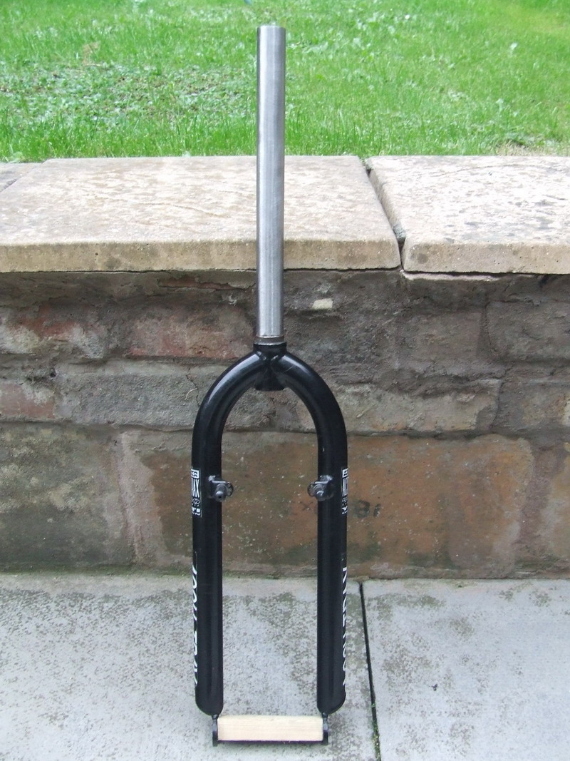

No, plenty of people do it (Option B) , myself included and if you feel that guilty about it the job can be reversed.
Spot the join?
neilll":1duw63c0 said:
Spot the join?
:shock: holy, no! where's the join?
reversed? please elaborate :?
Cut it back off and redo the steerer but 26tpi threaded.
The forks above had a short threaded steerer to start with, same problem as you. I will always 'fix' this problem in the same way now (and that will include my Powerlites if they come up too short), its quicker/easier than hunting down more forks ;)

if the post is a press fit then you may have huge problems getting it out without damaging it, for a set of Magura forks i did we had to cut it right down to get enough pressure on it in a vice, it was flexing,
To fit a new one i made we machined it at the workshop where i worked then used a method called cold press.
We placed the new post in liquid Nitrogen and then pressed it in, only way you will know that it will never come loose with a press fit.

Cut off below the threads, new section of steerer tube prepared, internal sleeve and welded back up. 100% reliable, very strong and I recommend it totally, here it costs about £60 to get done by a good framebuilder.

Or use a 30tonne press like I do ;)
