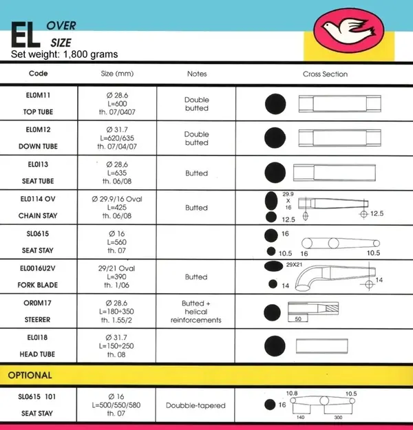

I've seen a bike with a columbus EL sticker, but also saying "reinforzati". Is this the EL-OS ??
Because I've never seen an EL-OS sticker , and I believe the one just saying Extra Leggere is the plain EL while the one saying reinforzati should mean the oversized version. (I'm far away so I can not measure the diameter of the tubes that I believe should be the right way to conclude if OS or not OS ;)

'Rinforzati' is for butted tubing
The (oversized) tubing diameter dictates whether or not it's EL or EL-OS
EL: TT 25.4, ST 28.6, DT 28.6
EL-OS: TT 28.6, ST 28.6, DT 31.8
