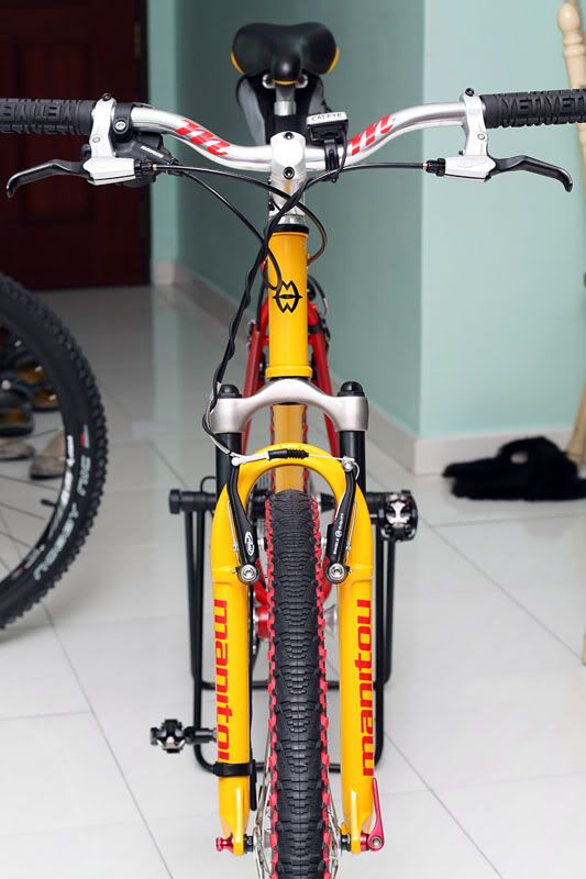

Hi all. I'm here to share the successful makeover of my vintage 1994 Gary Fisher Rangitoto. This cromoly bike has been through thick and thin with me on and off road for over 17 years. I has since retired it due to its poor condition, but couldn't bear to throw it away. Hence, this slow and budget restoration job to bring this hardy bike back to its former glory. Enjoy.
Steel frames might be heavy, but they're built to last. I've clocked thousands of kilometers and broke many components except for the frame.

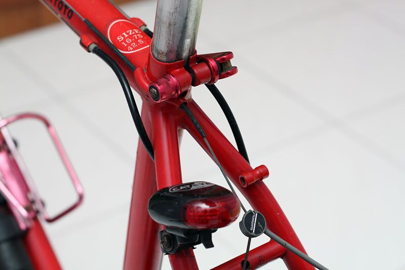

Problem no. 1: This bike is designed for cantilevers only. I'll have to ditch the front derailleur to use V-brake in this case without resorting to messy cable ties.
Problem no. 2: Dents, scratches, rusts, stains and whatnot. The frame is a far cry from its original shine.
Problem no. 3: Heavy pitting caused by extensive rusting. Other teething problems: Faulty 21-speed brifters, derauillers and suspension fork.
Stripped the original paint, then applied primer, colors and lacquer. Gary Fisher decals are sourced and purchased online, while the Rangitoto wordings are DIYed using vinyl lettering.
Phil

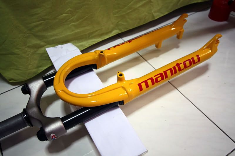

Bought a second hand Manitou Magnum manufactured back in 2000 for US$33 and repainted the fork legs to match the frame. Vinyl decals ordered online again.
Phil

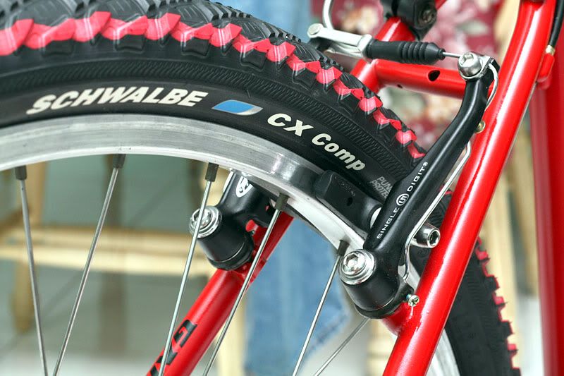

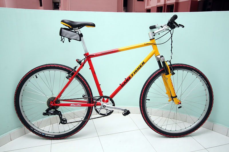

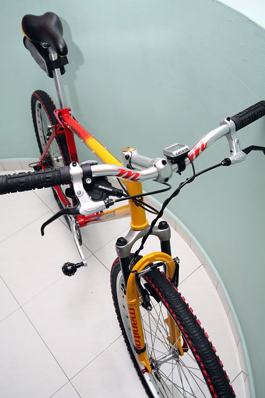

The bike in showroom condition again! Total bill adds up to US$210. It is now converted to a 7-speed commute bike. :) Final component list.
Main reconditioned parts
- Double butted chromoly frame
- Ritchey threadless headset
- Shimano Deore LX bottom bracket
- Shimano Deore LX crank (single chain ring)
- Bontrager rim with Shimano Acera X hub + 7-speed cassette
- Araya rim with Shimano Exage hub
- Manitou Magnum fork
New parts

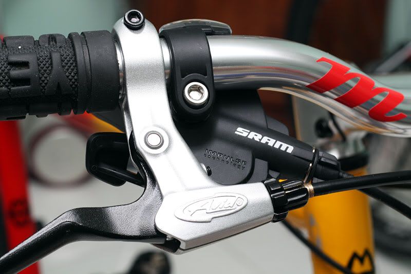

- Avid Single Digit 5 V-brake set
- SRAM X3 7-speed shifter + rear derailleur
- Schwalbe CX Comp semi-slick tires
- Clark brake cables
- Raleigh raiser bar
The whole bike now weighs slightly over 11kg and works like a charm. Fast, quiet and nimble.

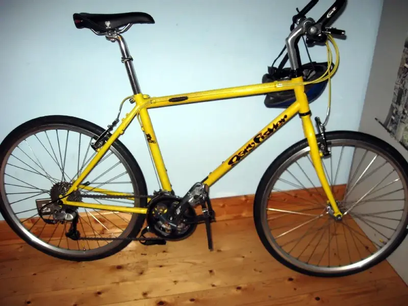

nice bike, looks a bit like a 98 marlin
I got a marlin frame off ebay and sprayed it up but I repaired some bad scratches etc and then blended the paint into the existing coat before re-laquering the whole. That saved replacing the decals as I couldn't find the same ones anywhere. I didn't have any of the original parts so just used mostly deore lx, nothing too fancy. I used mavic d531 rims on the wheels as I am about 170 pouinds (plus). I will try to attatch a pic for you.
russ[/list]
