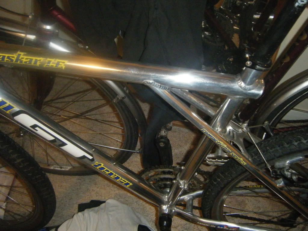

I achieved the shine on this ball-burnished Zaskar using Autosol Aluminium:
Thanks for the replys. Wow paul your zaskar looks amazing! I would love my rts to look like that but I thinks she's too far gone but time will tell!

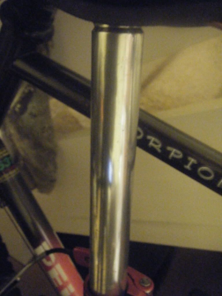

I have a seat post which looked far worse than your pic I improved it's appearance with fine sand paper, then wet and dry, then autosol (regular)
The black spots are scars from the pitting which was underneath corrosion which had occurred becasue of crud on the suface
As you can see, LGF is right, these 'raw' finishes will oxide back up, if they are kept clean they will remain looking good, but go flat takes a good while though That seat tube is now 'silver' did look dazzling about a year ago

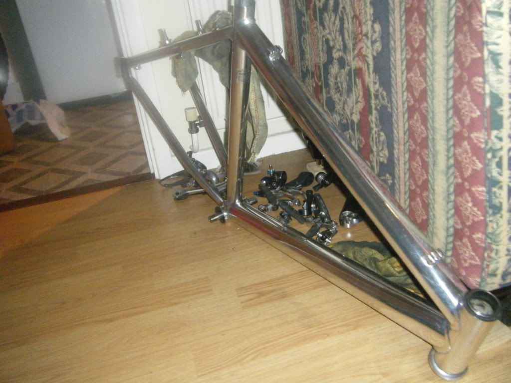

I have a build in progress which is destined to be mirror polished raw aluminium
It was lacquerd so I stripped that then wirewooled it using brillo soap pads with autosol and T-Cut on them
Next just Autosol
I'm going to T-Cut it for the full on mirror shine once i have te energy
I didn't use sand paper on a frame and wirewool has the massive advanatge that you can douse it in other goodies and it's flexible, fits really well round curves and into tube junctions...
Nearly there!
So I'd recommend the same to you, start with wirewool it'll go ll gray but hopefully flat, then autosol, then something really gentle like T-Cut or Brasso as most others have said. However for the heavy artillery, on any massively scratched parts used cautiously sand paper could save a lot of arm ache
