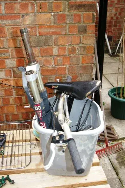

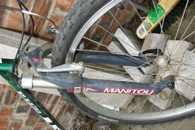

File comment: The Mach 5 XC Pro goes as far as the outer leg, due to a mix up during a recall I ended up with Pro outers on Comp inners... The elastomers have survived 15 years of misuse! The sticker on the top says 'It's Mine' and it is once again...

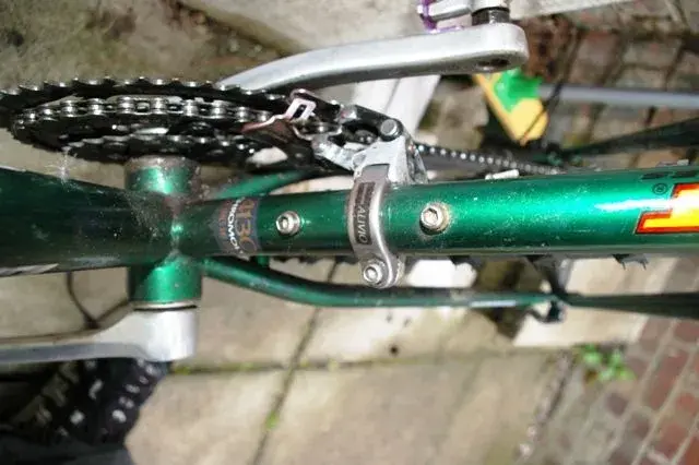

File comment: Signs of youthful upgrade spending with an LX rear mech replacing the Alivio original. Not a clue why to be honest.

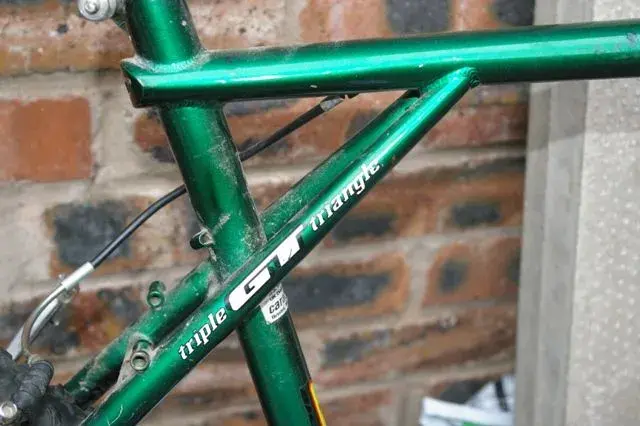

File comment: The 'Marmite' triple triangle. Also the bike has the groove tube. Note bad cable routing for 'upgraded' V-Brakes. eep

The original fork would have been a Rock Shox Quadra 10, I assume the bike shop took that off and sold it on to someone else at some point. As I mentioned, it had a Tange fork on it when I got it. That's gone now too, sadly. The Mach 5 was a Christmas present and wasn't a great fork. It currently has the soft elastomers on and I get about 1 inch of travel, pretty much all I ever got. I'll overhaul the forks before I use it but I know they needed new bushings when I gave them away. Not sure I'll find those easily and not sure I'll be able to get the old ones out anyway.

File comment: The frame is a patchwork of chips, scratches and free MBUK stickers... I'm loathe to repaint it though. I'll probably just use a bit of Kurust on it and call it 'character'

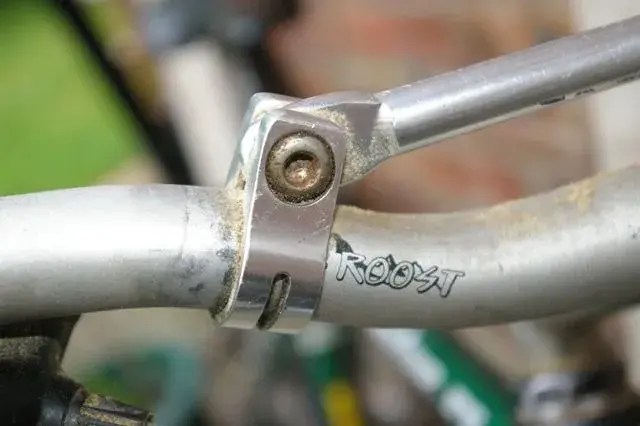

File comment: Mahooosive and messy stem, next stop will be the bin for this bad boy. I never did buy a headset spanner when I was a teenager.
File comment: Who didn't have a Club Roost Go Fast Comp in the 90s? Combined with that long stem, if I fell off this thing at the top of Rivington it would roll all the way to the bottom without me. I may replace this with a flat bar...

The BB has survived 15 years of punishment and only a mild grind to it. Probably best to replace it.
The headset is a sorry case... When I pulled the fork off, the bearings exploded out of the cartridge and scattered across the garden.
Are LX bearings easy to source? Would have been around 1995/96 that it was fitted. I might be best getting a whole new headset.
