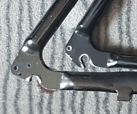

Hi there,
I was wondering if someone could point me in the right direction of which rear derailleur hanger I need for this Cannondale frame, I've had no luck so far and any help appreciated!
Thanks

Hi, Looks like my Killer V ( 1996)
My hanger had cracked on one side, I managed to get a replacement from a CNC specialist in Israel who makes a wide range of
gear hangers.
Mine is marked ' D 46 ' which is presumably the pattern/type number. I will get back to you when I can find more info
A quick update
You need a Cannondale A239X Gear Hanger which is similar to a Pilo D 46 or a WHEELS Mfg no.16
These Hangers fit 'around' a 6.4mm wide/thick dropout
There seem to be two types of D 46 Gear Hangers that I have found ! I can only guess that there has been
a re-design for some reason
If you Google ' Pilo D 46 Gear Hanger ' and scroll down until you find 'Pilo D 46 RED' it shows what
I believe to be the correct and original design for your bike
Hope this helps
Yes, Thank you so much for that information, so specific, a huge help.
Definitely looks like the right one.
Cheers!
