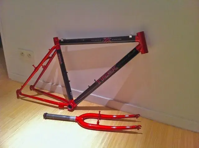

For the past few years, it was collecting dust in the basement, looking rather sorry with rusted parts and very poor paint. A few weeks ago, I decided this trusty stead deserved a proper restoration. I stripped it down and had it repainted, including new decals:
It's not perfect: the colour match is not perfect and there are some details on the decals that are not entirely correct, but for 200 GBP I'm pretty pleased with the result.

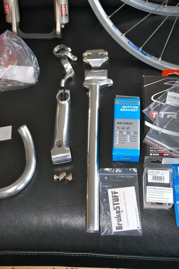

First up: fitted new brake bosses, which took some searching, but I found the correct size in stainless steel at brake-stuff.de in Germany.
I also decided to polish the seatpost, stem, handlebars, and cable hangers, which were anodized clear but scratched heavily after 20 years of use, and replaced the bolts with new stainless steel ones. The most difficult one to source being the shallow-headed bolt for the stem.
Old bolts versus new bolts:
Polished parts:
