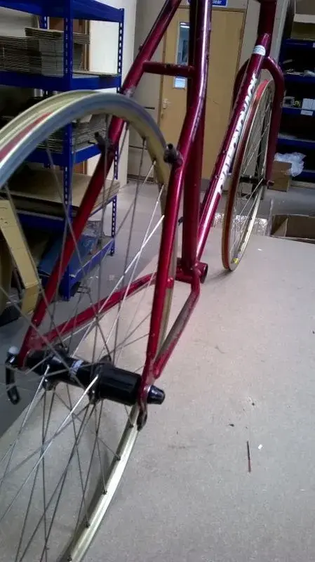

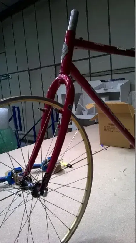

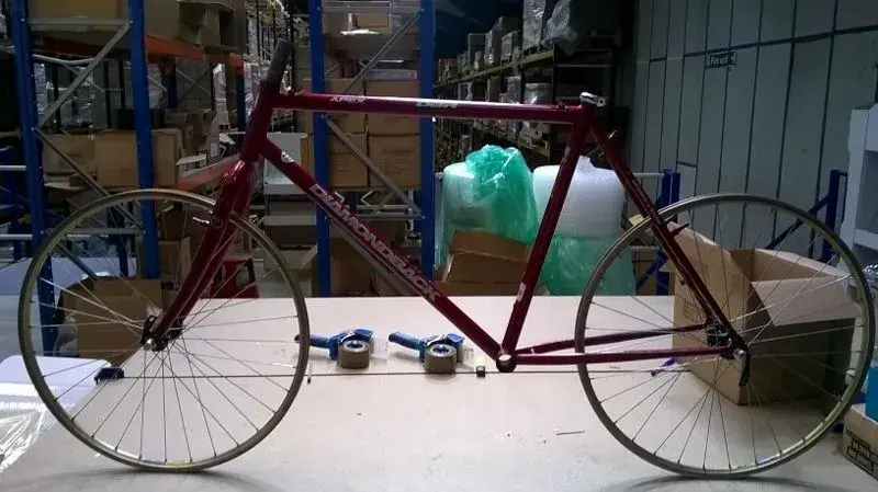

got wheels.

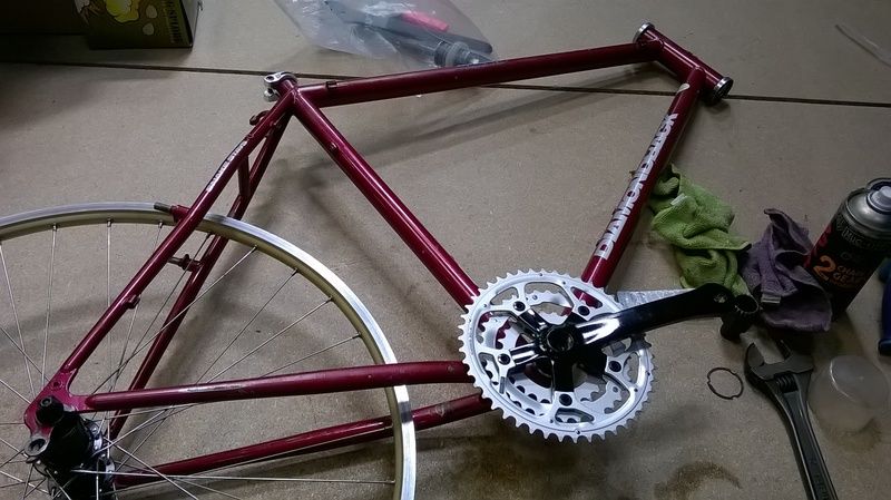

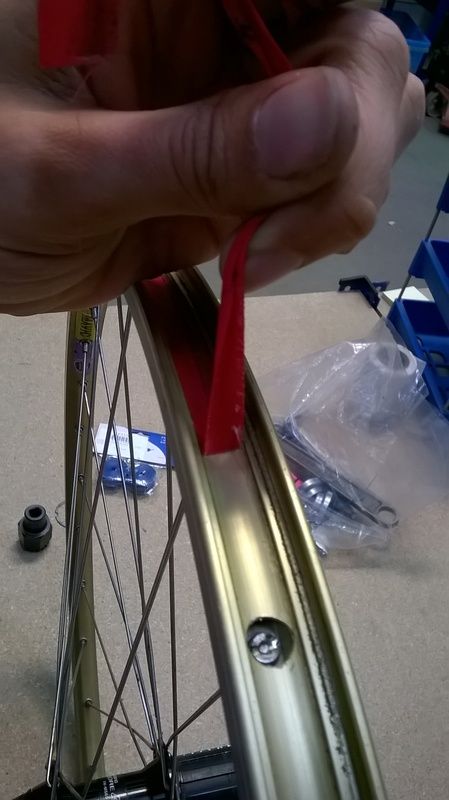

right, so between yesterday and today i have:
Stripped the old rim tape off
Removed the rogue ball bearing from rear hub
installed headset
installed bottom bracket.

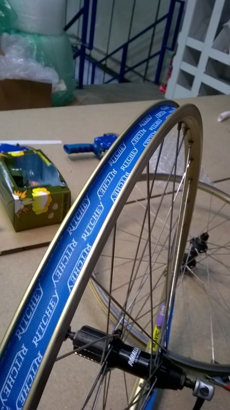

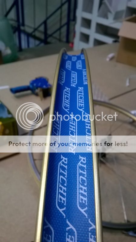

i found pulling the rim tape slowly and at 90 degrees to the rim made sure it took off as much of the glue residue as possible. will need to remove the rest by cif or nail varnish remover.
i ran half the new rim tape into the rim to see how it fits (nice and snug :) ):

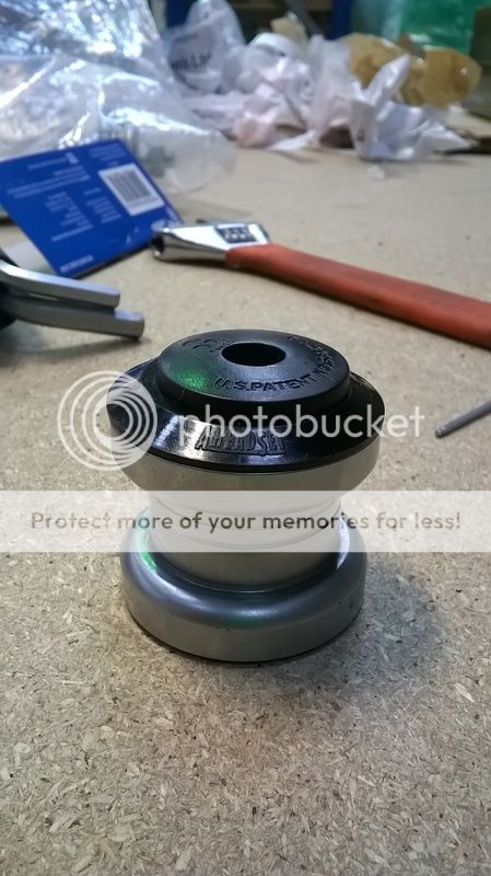

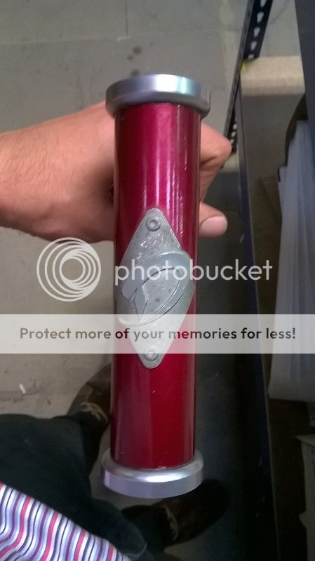

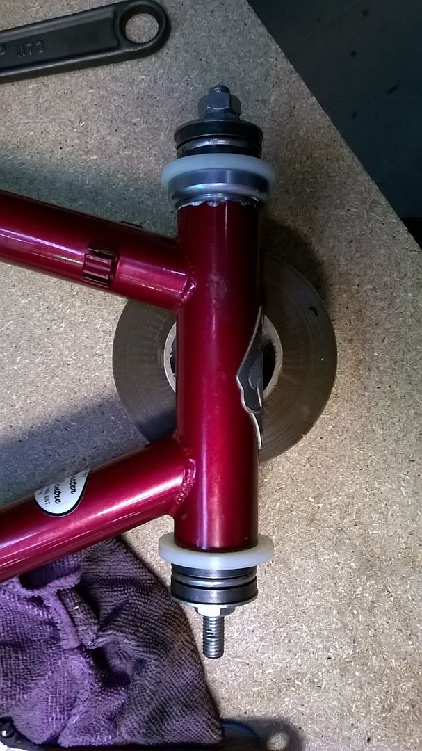

then on to the headset. very carefully inserting one cup at a time. dab of grease to ease it in:

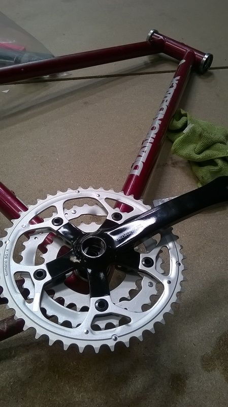

then on to the Bottom bracket. i hand turned it in to check threads were clean. added a dab of grease and checked te crank/chainring clearance before tightening and fully installing the BB:

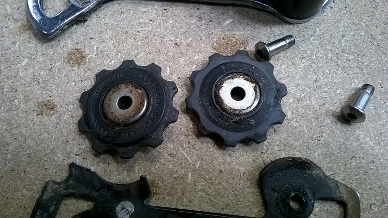

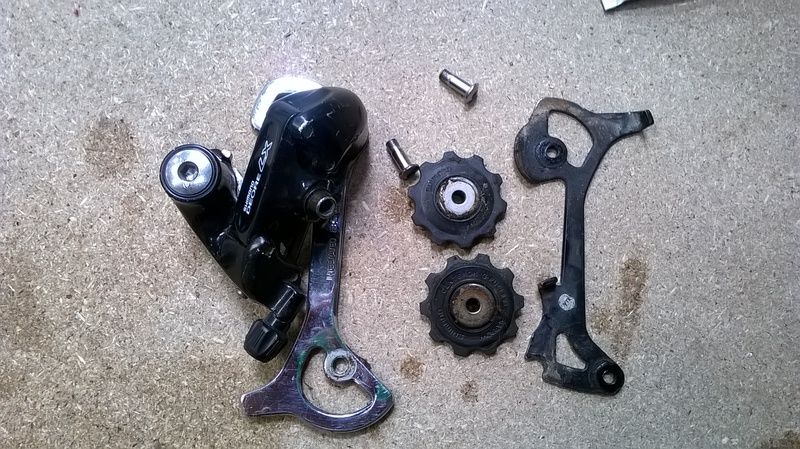

then took to the rear mech - stripped it to see what state the jockeys were in. not great, but think i have some spares at home. some corrosion/pitting on the cage, but may take my dremel to that if i can be bothered and respray the backing plate black. might see if i can get a sealed bearing centreon jockey wheel to tart that up a bit ;):
pics arent the best quality. phone/potato camera :P
