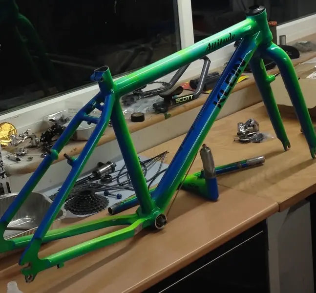

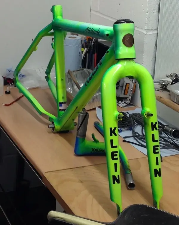

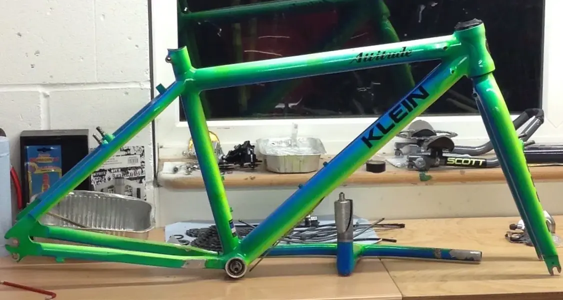

This will be a lot more straight forward compared to my last build!, a lot flippin' cheaper too :facepalm: It's no show winner and needs some love which I have started to give it already with a deep clean to the frame.
Rear mech thread is damaged so it will be getting a Helicoil insert fitted. It's suffered from the old chain suck so needs a little tidying and some touch up paint. New bb bearings and cable guides will be going in as always. MC1 has been cut down and ends crimped from bar ends, I'll cut these back and get some extensions machined up and fitted.
As for parts, I have a XTR M900 group in good condition for it, a Flite, black wall Ritchey tyres and a few other bits.
Some crappy pics at this stage late in the garage.
