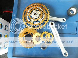

Then came the moment that caused a big swerve on the journey - a rare chance to give me a full British chainset with the appearance and outing on eBay (thanks guys) of a Goldtec Ti Cassette and rings attached to some of the nicest Middleburn RS3's I'd seen. Pure Ti retro porn! Loving the ramps on the middle chainring - that's not something you see much of on aftermarket rings. Oddly enough they were the from same guy who sold me the Quarz rear mech a do few months earlier who was selling off his collection.
Only trouble was the now finishing kit was too blingy - blue and gold ano was never going to cut it together. To make the decision easier the Hope BB was too long for the low profile RS3's. A short wait on ebay and a plain silver Hope BB arrived in much better condition and at 109mm closer in ideal length for the RS3's.
