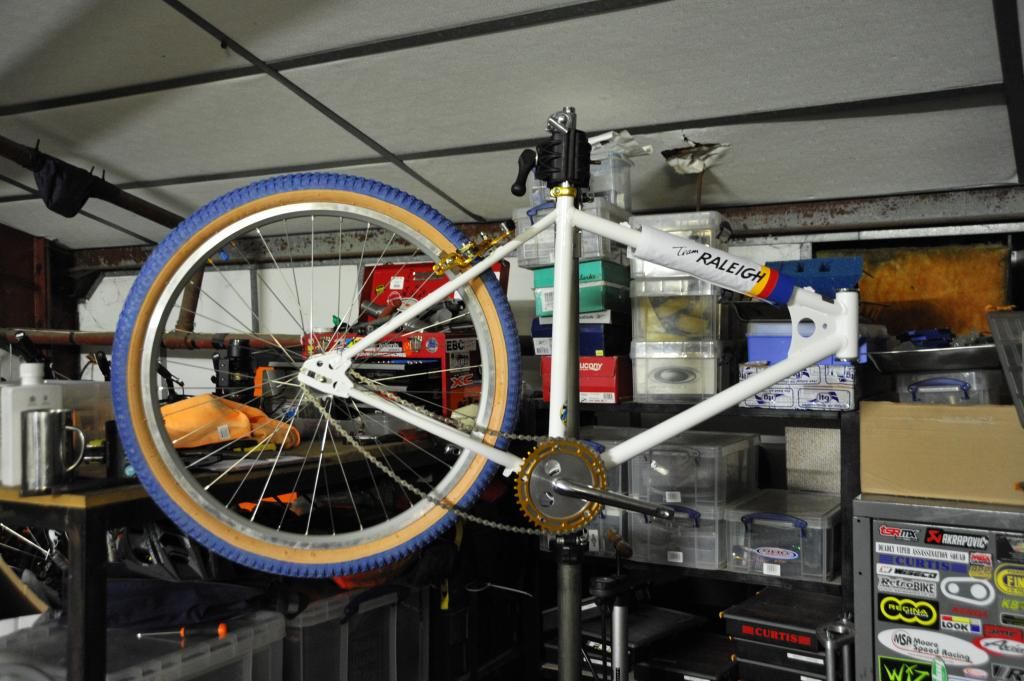

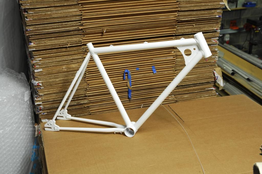

Since it is going through such a big transformation, I thought it would be nice to show it here. The frame was collected today from the powder coater. I used a different company this time, a new startup that are specialising in car wheel refurbishment, I just wanted to test the water really.
Not bad at all, £45, which crucially included stripping the old colour off. My usual coater only paints, he has no provision to strip or blast. Very happy with the result.

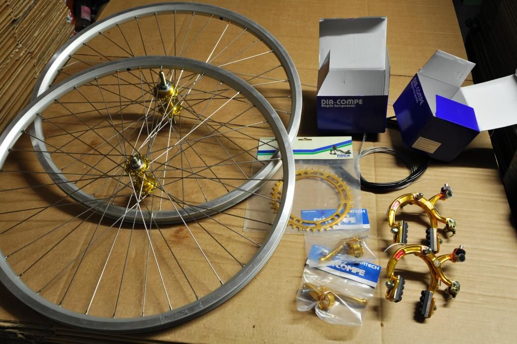

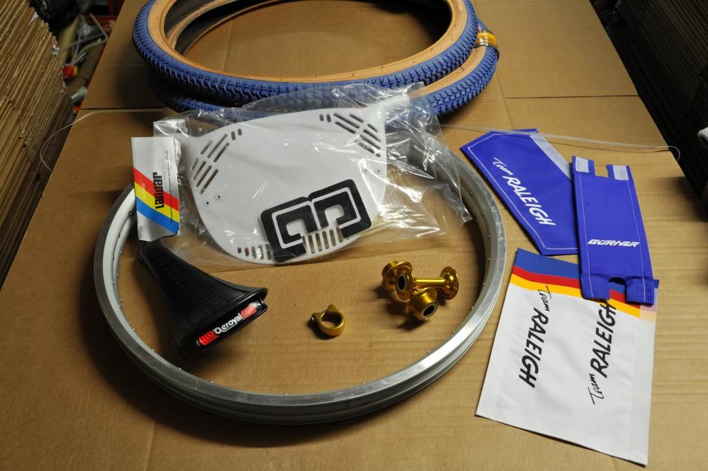

In other news, the forks have been dropped off for the chrome to be stripped, and should be back with me next week. I have also been amassing some parts for the built, a good percentage has arrived already:-

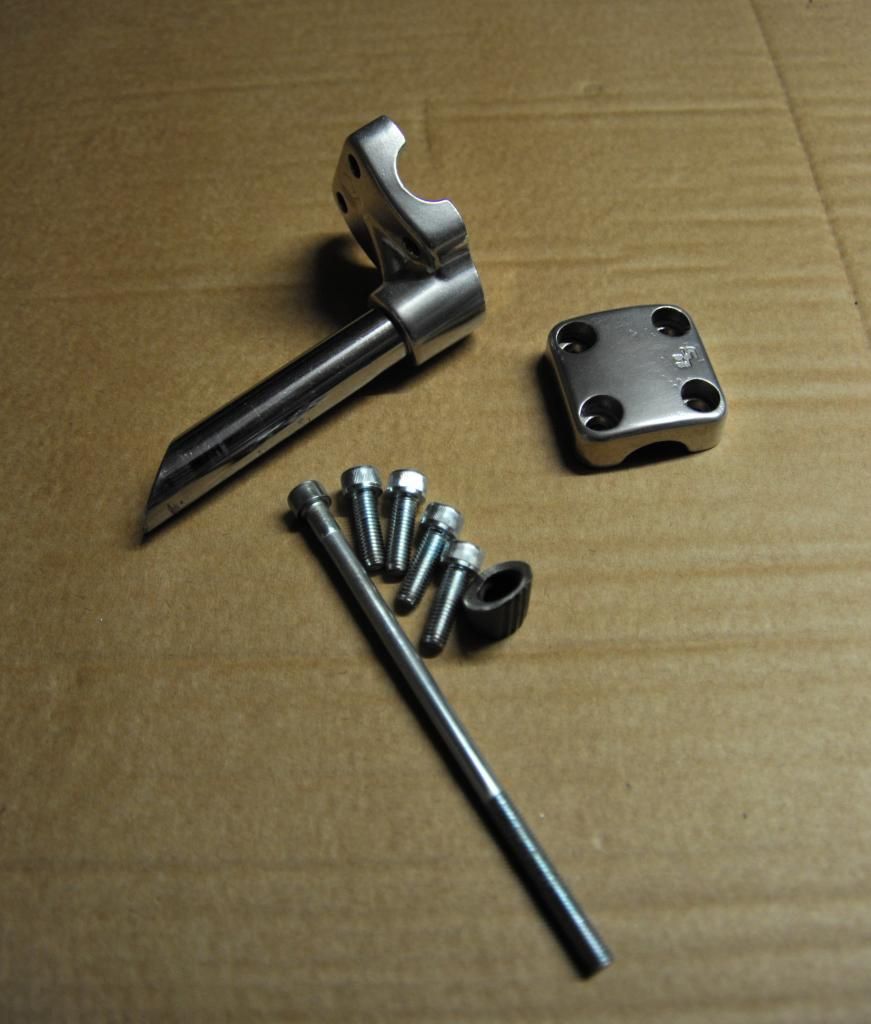

I have also sourced a Sakae-Ringyo MS422 stem, and this has been cleaned up. The top loader bolts are new, safety first, but the quill bolt has been replated.

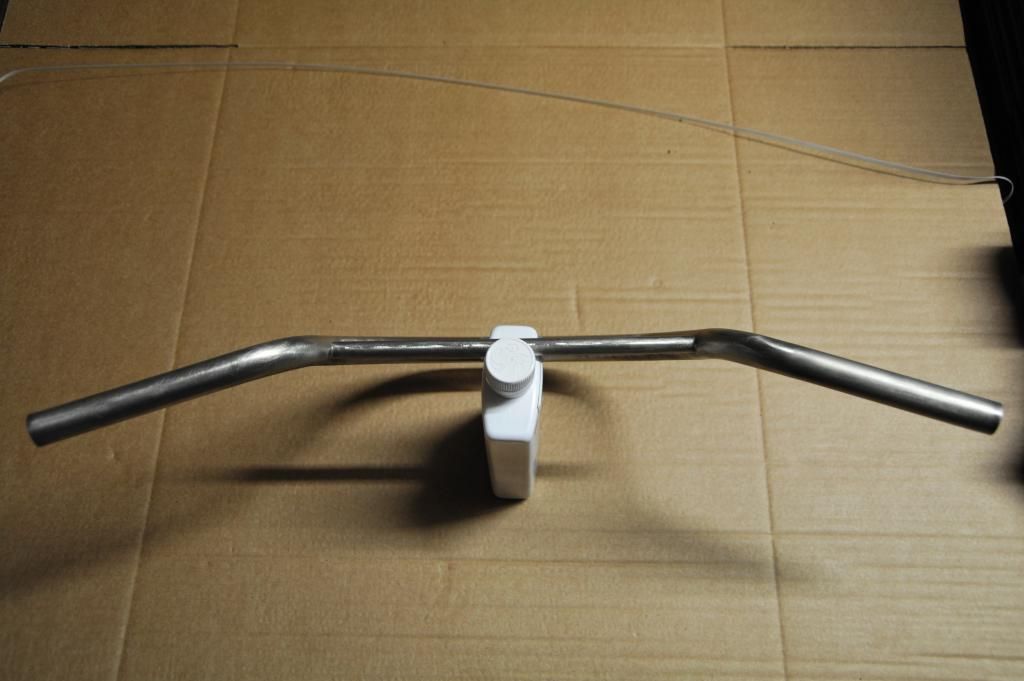

Ooh, ooh, and the stem came with some bars too, again they are proper Burner bars but as you know the shape of Raleigh bars is rubbish, so i have modified them. Compare these to standard bars, I have straightened them out a bit with the oxy-acetylene torch...

Today has been pretty productive, I picked up axles, spokes, and nipples for the wheels, and also picked up the new brakes.

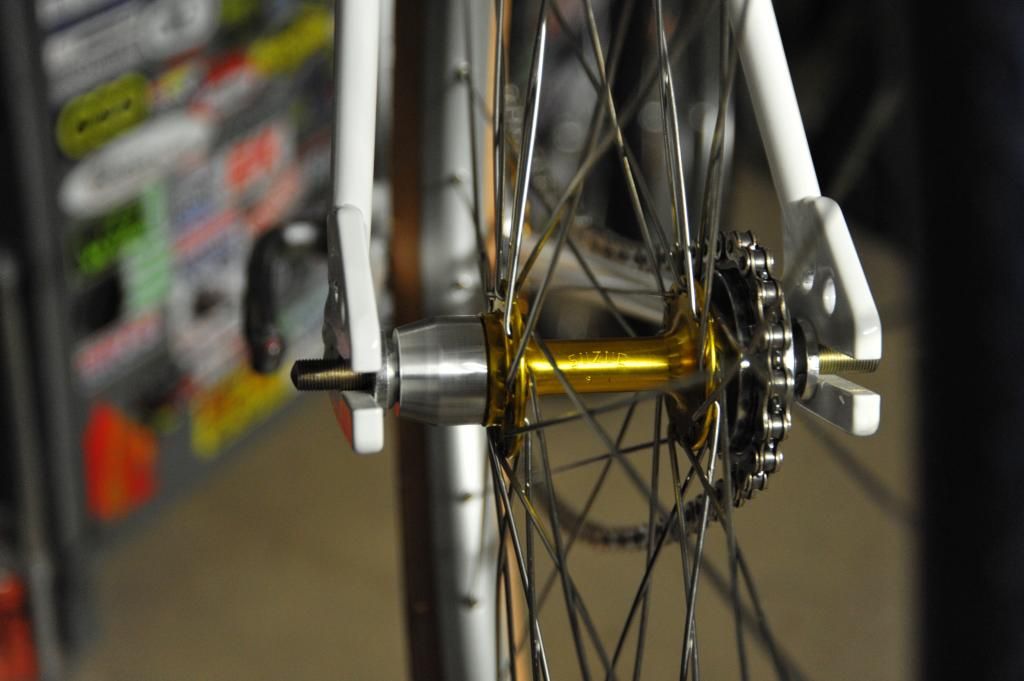

This evening I built the wheels, pretty easy as the hubs are symmetrical and the rims are stiff.
I still have the rear axle spacing to finalise, I will have a proper look at this over the weekend as I have a cunning plan. ;)

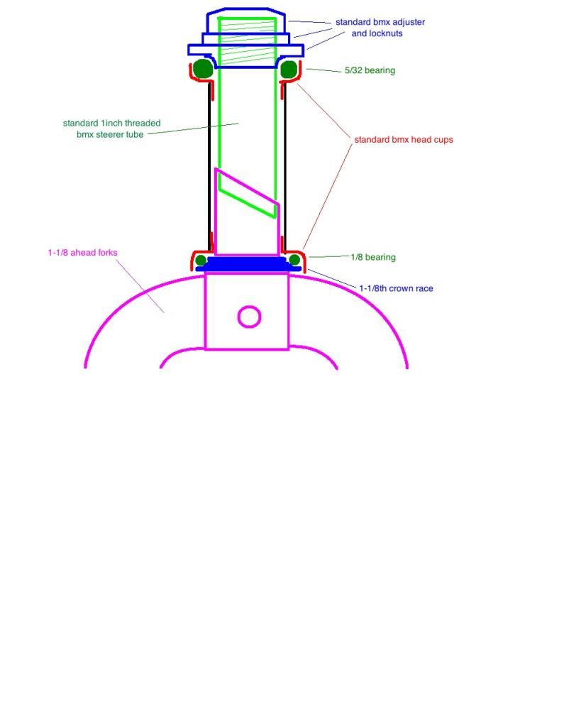

And an explanation of the fork set-up.
I ran the forks straight 1-1/8th" ahead in the past, no problem, so I know the 1/8th" bearings are up to the job. The 1" threaded steerer is from a raleigh max, so has the correct 21.1mm i.d., this I stitch welded in three places, and then flooded the join with brass. It should be plenty strong enough...
