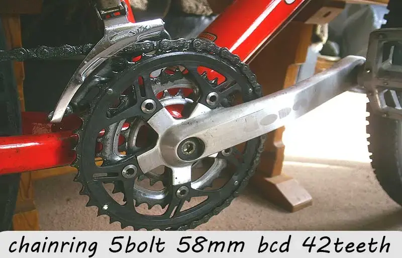

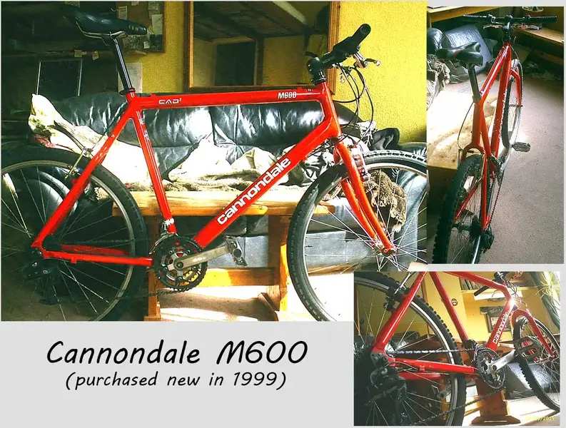

I have a question, well actually I'm looking for replacing my worn out chain-ring for my ol' trusty cannondale M600, I baught new way back in 1999.
I'm looking for a "chainring 5bolt 58mm bcd 42teeth", guess I'll be needing a
chain too.
I'm not rich but would be ever so grateful for even a part worn matching replacement.
My searches have so far yealded nout and if anyone cares to offer suggestions towards a replacement running-gear, that'll be great too.

You sure about your bcd? 58 is usually an inner on 5 bolt compact, with the middle and outer being 94.

Thanks for replying, Clubby
You're right, I measured the diametre of my outer-ring's bolts and is indeed 94mm! So would like to make the purchase please, how?
btw, have attached a couple of pics-
