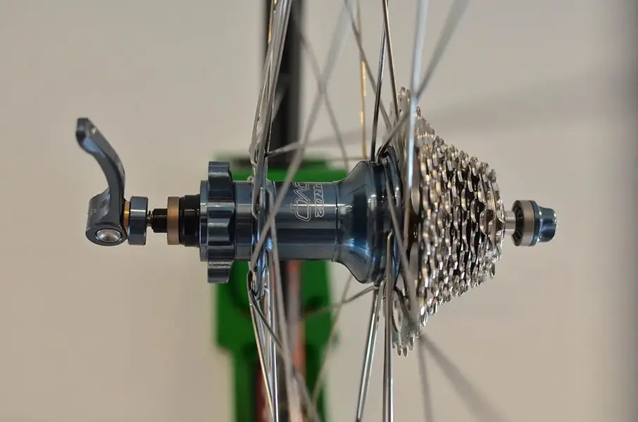

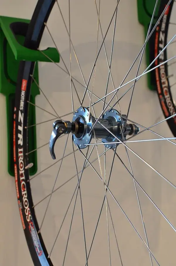

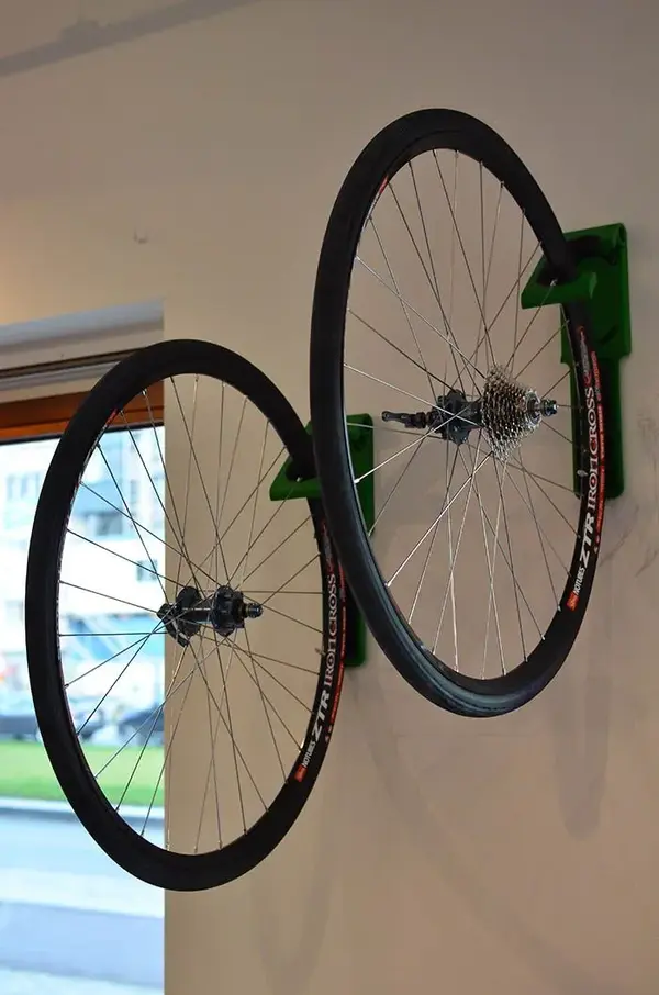

Wheels done! All and all build very easily round and true.
32h ZTR Iron Cross rims 385 gr
32h Hope Pro Evo II 40t f185/r285 gr
Dt Swiss revolution spokes & nipples x 64 315 gr
Cassette + QR's + fat tires = heavy
But will make me proud on the road ;)
