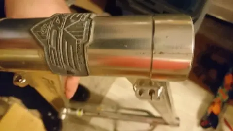

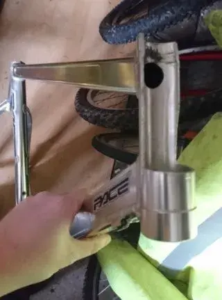

I want to keep and reuse the head tube badge. Rivets wouldn't budge so decided to attack from the rear, so to speak, so it's been for a pre-chop chop :)

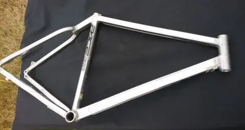

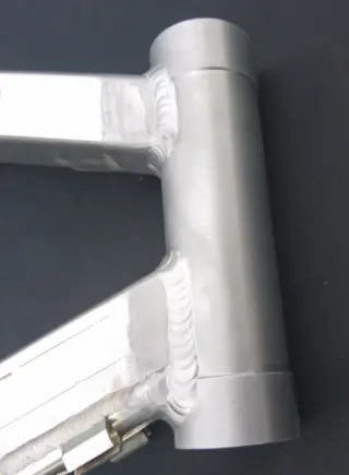

Dan brought a little something to Mayhem for me...
Great work as always, just need to work out how to finish it off now :D

Still not decided how to take this forward. My red 16 in her (ooh-err) is fine and dandy but am still thinking this larger one would be a 'better' size. Plus it's been hanging in the wall since mayhem 2019 and it looks lonely
I think I have 4 options.
1. Leave it as it is, build it.
2. Acorn to be properly stripped and anodised some beautiful shiny colour. Not a cheap option.
3. Powder, got a local place that has a decent rep. Guess it would need some work to strip the ano finish off though anyway?
4. Paint. Sand it, rattle can, doofer job. Just waiting for the weather....
Or I could just leave it hanging on the wall another year I suppose
Number 1 for me. You can always decide later if you really need it re anodising or coating.....tbh I find mud and British dust from the trails the best finish ;)
If you do go for #3, powdercoat, it shouldn't need any additional work, as the PC will cover the same on the bare metal and the old anodising.
