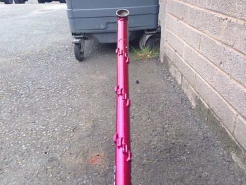

What the pictures in the ebay listing don't show, is that because there are so many weld on cable guides on the top tube, the tube is actually ever so slightly bent. It was really hard to photograph, but easily noticeable in person.
I knew this, I spotted it he day I first saw the bike, and have been ribbing him ever since. I also knew that it was repairable, but its really difficult to get the noisy tools out on something that has cost so much money. Not so difficult for me.
Difficult to make out from the pics, but I made up a fixture that would allow me to jack the frame slightly, I needed to spread the load as widely as I could so as not to damage the frame anywhere else.
Done. There is a fraction of a millimetre now front to back with a straight edge, not something that you can detect with the naked eye.
Next up was to remove most of the cable guides. I need the guide for the rear brake, and chose also to keep a set for an uppy-downy seatpost.
So many guides, sigh.

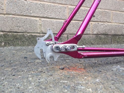

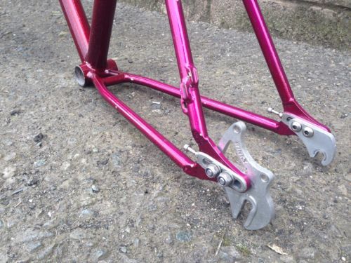

A quick dust over with some black paint to keep the rust at bay, and shes pretty much ready to build. While the paint was drying, I set about finding some suitable parts for the build. The front end whole is from the Foes, while everything at the rear is from the box-o-spares.
Do need some crank bolts, cant seem to find any the right size. but the cranks are pressed on so the bike is rideable. First impressions are good, tho I think I need a slightly longer stem, 10mm should do.
