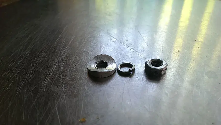

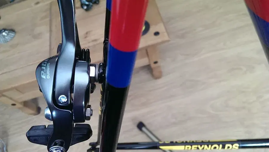

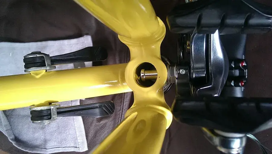

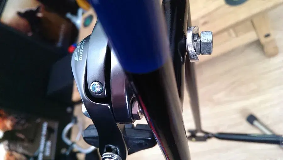

Anyway I have gave this a go, not sure what I am doing so I just wanted someone to look over this and see if it looks alright?
I am a bit worried about the washer and spring washer and nut combo I am using as I took this from the original set of brakes.
Am I good to go with this do you think?
Thanks :oops:

Drill the crown, use two front brakes.
That front brake risks the crown cracking and pulling the brake it when you least expect it.
Get some better washers and a nyloc for the back.

You have the U shaped washer on the wrong way round.
The curved portion is supposed to be against the outer diameter of the tube giving the flat surface for the spring washer and nut to act upon.
See... Now I'm glad I asked :lol: :oops:
Thanks for spotting that NeilM i'll get right on it 8)

You only need to drill the back of the fork and get a longer sleeve nut so that it reaches. They are easily available for carbon bikes with oversized forks. You may be able to do the same with the rear but will need a right angled drill attachment even then you may not have room.

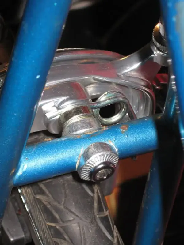

Heres how those concave washers work for the rear brake:
Dont be afraid of drilling but if you are, theres nutted brakes available, you'll have to check the drop
https://www.velovitality.co.uk/products ... tted-brake
