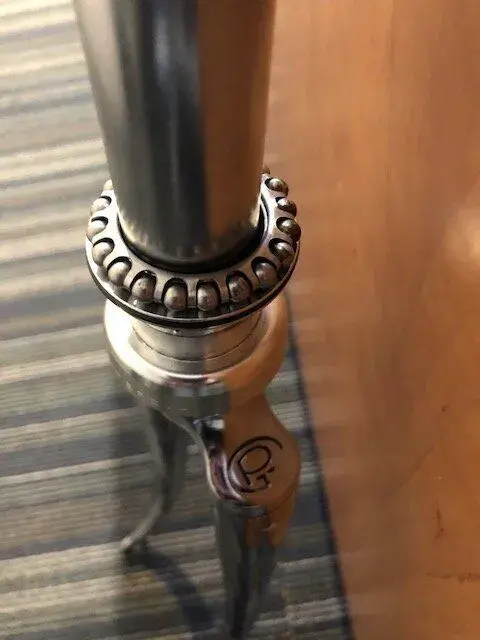

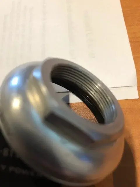

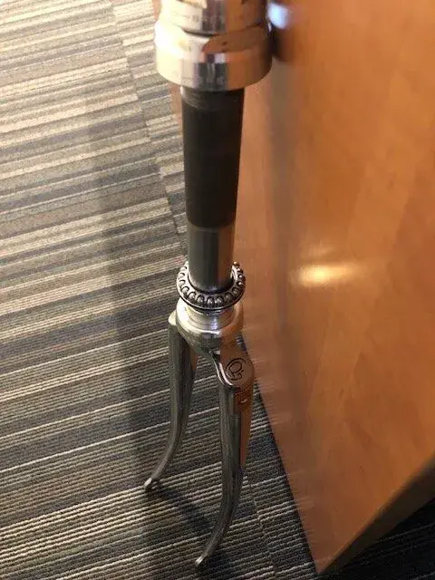

I have a frame being renovated at the moment but have the forks at home as they are all chrome. I was just sorting out an Italian headset for it and was having a problem getting it to thread on to the steerer. I didn't want to force it and just happened to try an English threaded cup and it flew on.
I wasn't expecting that. Is it the case that someone has recut the steerer thread or could it have been supplied like that?
Cheers
John
the fork is stamped on the steerer with the correct frame number: IP207 - so I'm pretty certain its correct. I haven't tried the headset on another fork but the top race are nut are stamped 25.4mm x 24F and the threads are clean and don't look damaged.

Then I can only thing your italian headset could be somehow damaged, maybe you can check it with another fork/steerer if not done already.
They look ok though - its a bit of a mystery.
The English headset will fly on due to the larger pitch size. I think a bit of a clean on the threads and perseverance and you troubles will abate.
The threads are the same so they are interchangeable, I think the difference is something to do with the angle the threads are cut?
I was putting a nice Italian Super Record headset on but may stick with the C-Rec British, When I pick the frame I could asl them to run a die over the steerer
