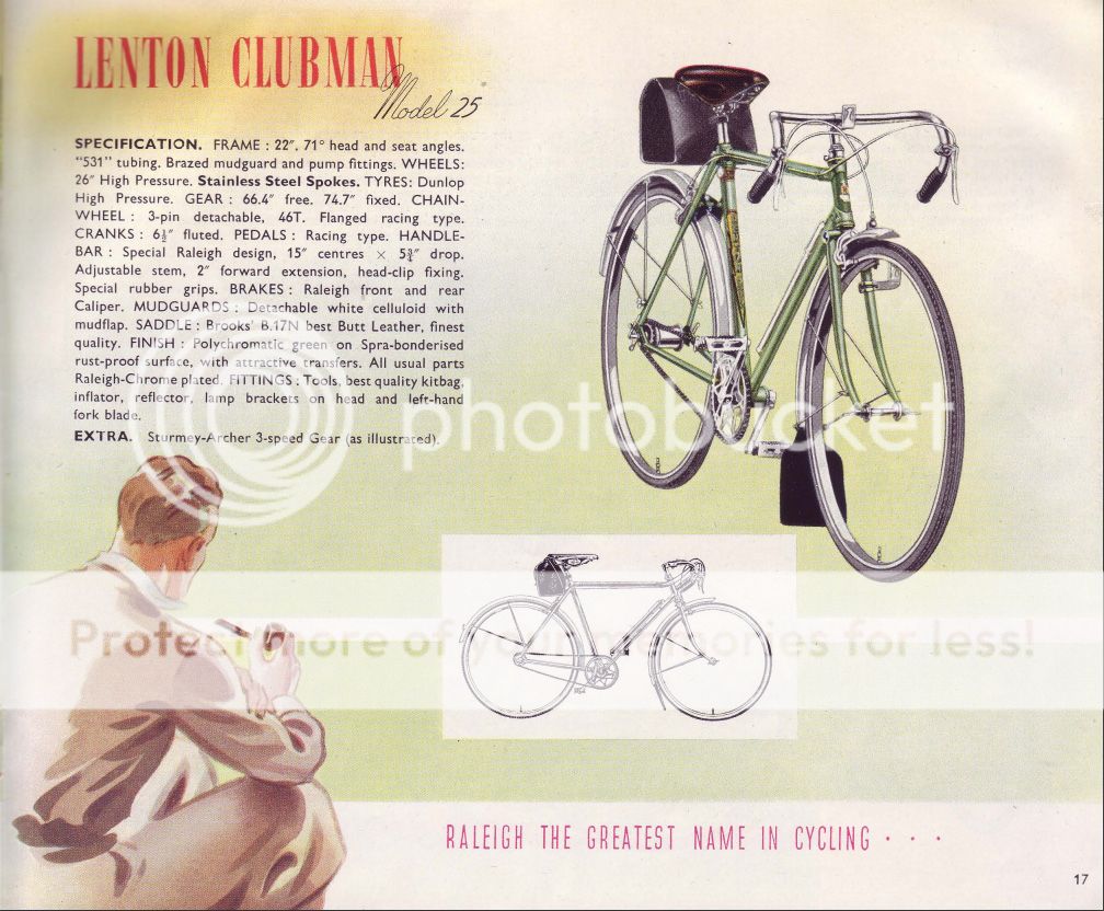

That's an interesting picture. From what I understand the Clubman and Sports were two different models but maybe I'm getting mixed up. On the seat tube it clearly says "Lenton Sports" and I've seen others that say "Lenton Clubman" instead but I wonder if that's a later thing. You'd expect it to mention something in the brochure and I was thinking the first letter of that branding on the top tube (bottom picture) looked like a "C".
The V-CC catalogue was described as the 1947-48, so it may have come out after your bike was sold to its original owner. So you may have the 1946-47 version.
The link I gave might be worth reading through to try to establish where your bike sits. He makes reference to the bike pictured in the catalogue as
The new Lenton Clubman as depicted in the 1947-48 Raleigh catalogue is not actually the Clubman at all but rather its shortlived (1946-47) predecessor, the Lenton Sports as it has the older pre-war Golden Arrow style chainring and the distinctive "flash" downtube transfer of the Sports model. Both it and the new Clubman had the same polychromatic green with darker green head tube.
What date is on the SA hub?
Can I ask a really silly question...... Why is the lamp bracket on the left hand fork? Are the pictures from the US market?

Absolute jackpot there Big Block. I think mine is the green one in the first set of photos which it describes as built 46-47 and has the same decals as mine as well as the same green. Think I'll message the writer, see if he has any photos from the other side.
Midlife: maybe the US was the bigger market at the time. According to that website the forks were a brand new design and my UK bike has the bracket on the left too.
