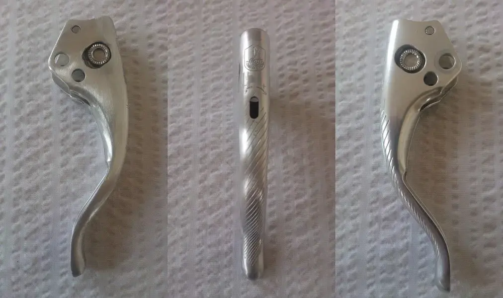

Thought I would make a short guide on how I go about refurb of campag parts. Others may do it different but this is what works for me.
First up here are the pictures of the lever that I am going to try and refurbish to the point where it can be used on a bike and not look like something from a horror movie. I bought a pair of powergrade levers from Italy. I already had one and need a match so I was happy to buy this pair as I knew I didnt need this one. I figured it would just go to the bin seeing as it was so badly damaged. Then i thought I would make this guide and it didnt really matter how it went as the lever was scrap anyway. (This obviously is just the lever blade removed from the body.)

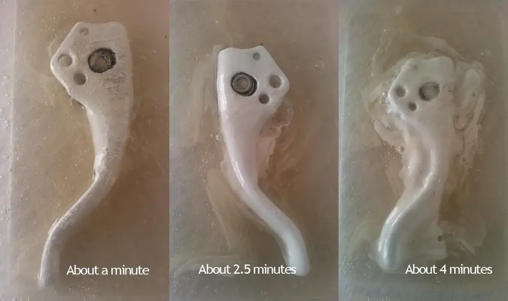

The first thing to do is to remove the anodizing. I use "Oven Pride". This costs about £3.00 from the "bargain shops". It is a very thick gel and is just poured directly over the part in question. I place the part in a blastic tray (a lunch box or something similar) and pour the gel over it. Be careful not to ghet this on your hands. The photo show the stages of the stripping process. The times are approximate but you can get an idea of what happens. I shake the part around as well. Dunno if this helps but it helps me...

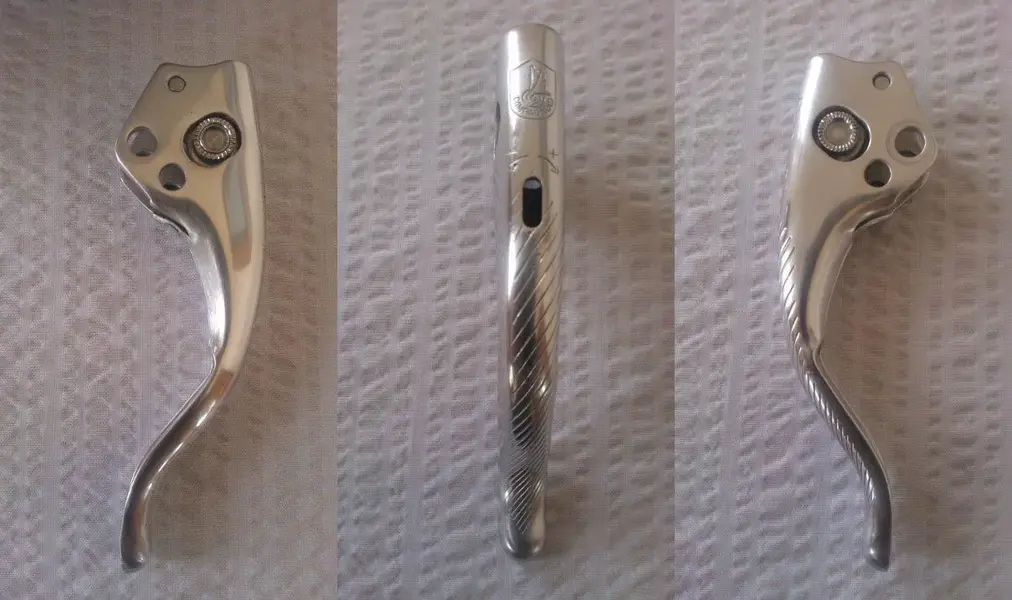

After about 4 or 5 minutes. I wash the part thoroughly under water and it ends up with a chalky dull appearance. All the anodizing is gone. If you didnt leave it long enough, just do it again....

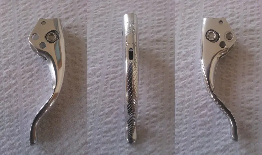

The next process is to get the sandpaper out. For the first stage I used 360 wet and dry because I have a lot of alloy to get through to get it down to a level. Here are the results after about 25mins of sanding. Not bad at all, even if I do say so myself. Obviously we have lost some of the engraving but this could not be helped. I always sand by hand, that way I was able to save the Campag shield logo. You might not be so lucky if using a mechanical process....

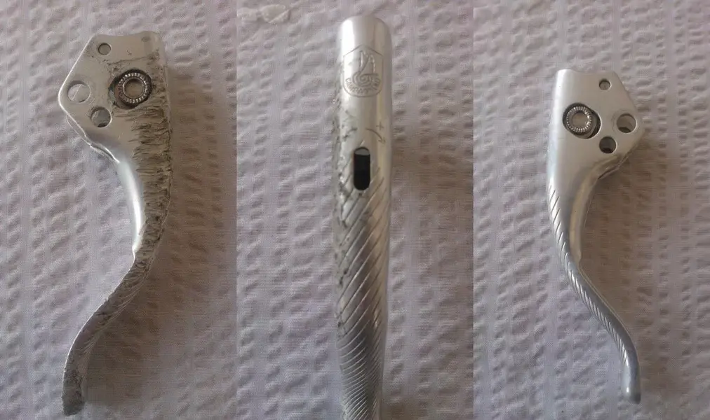

Next step is to get it a bit smoother......I repeat the process with a 800 wet and dry paper. When this is done I then do the whole lever with a 1200 grit wet and dry. Here are the results.....next autosol.
